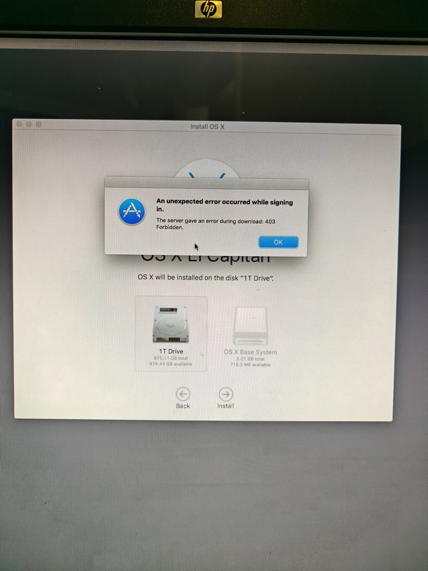

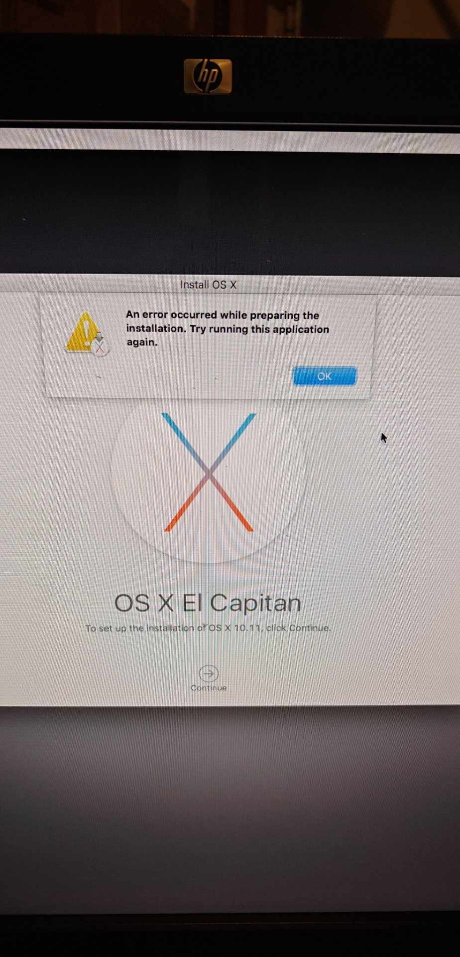

I've been trying to install macos El Capitan on my Mac pro 2009. But when I go to install it using my bootable USB, I get this error after I sign in to my apple id. After doing some research, I found that it might have to do with the date, so I restarted and set the date to 2017. But when I do that, I get another error that doesn't even let me get past the start of the install. I used transmac to make the bootable USB, and I fear that that might be the cause of the problem. Does anyone have any ideas?

(Error when I change the date)
i believe you have to change the date on the mac to trick it of something like that
But when I unplug the Ethernet cable, it doesn't let me install the os. It says that it needs an internet connection.
That happens when you don't have the full installer, Internet connection is needed to download the missing packages.
