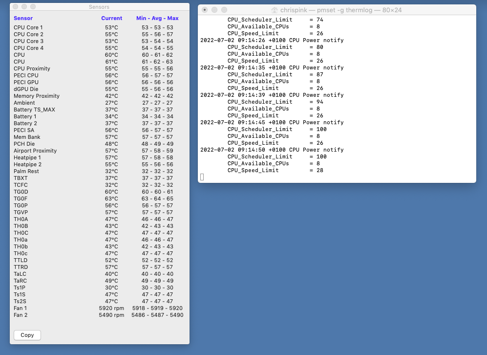

I'm now monitoring temperature with XRG and this is the situation just after startup this morning with charger in one side, monitor in the left. As you can see there's no excessive temperatures.
What else can cause CPU limiting?
