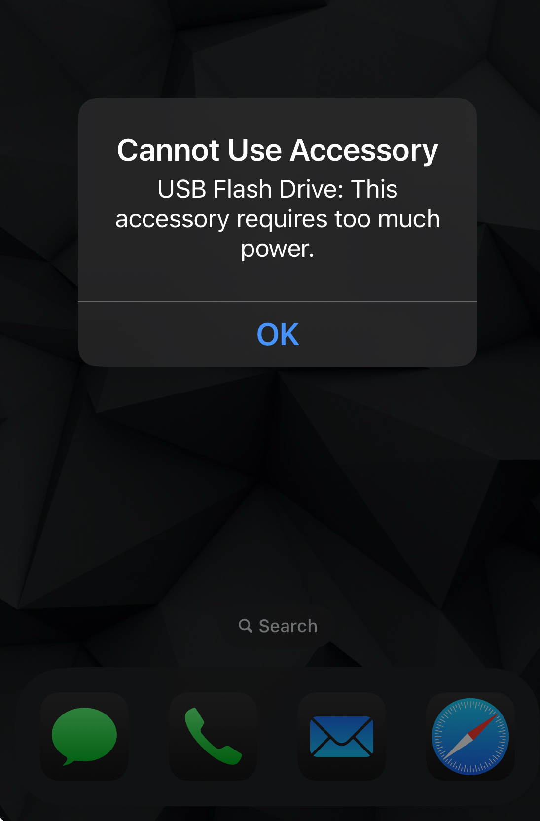

That's what I thought. I just tested it with 3 different drives with lightning connectors, on 2 different phones. None of the devices showed up. I DID get a popup on one iPhone for one of the drives needing software and I told it to ignore it. That drive was not visible on the iphone and I dont get the prompt anymore. This is beyond weird. I've also tried different filesystems, i.e. exFAT, APFS, etc..

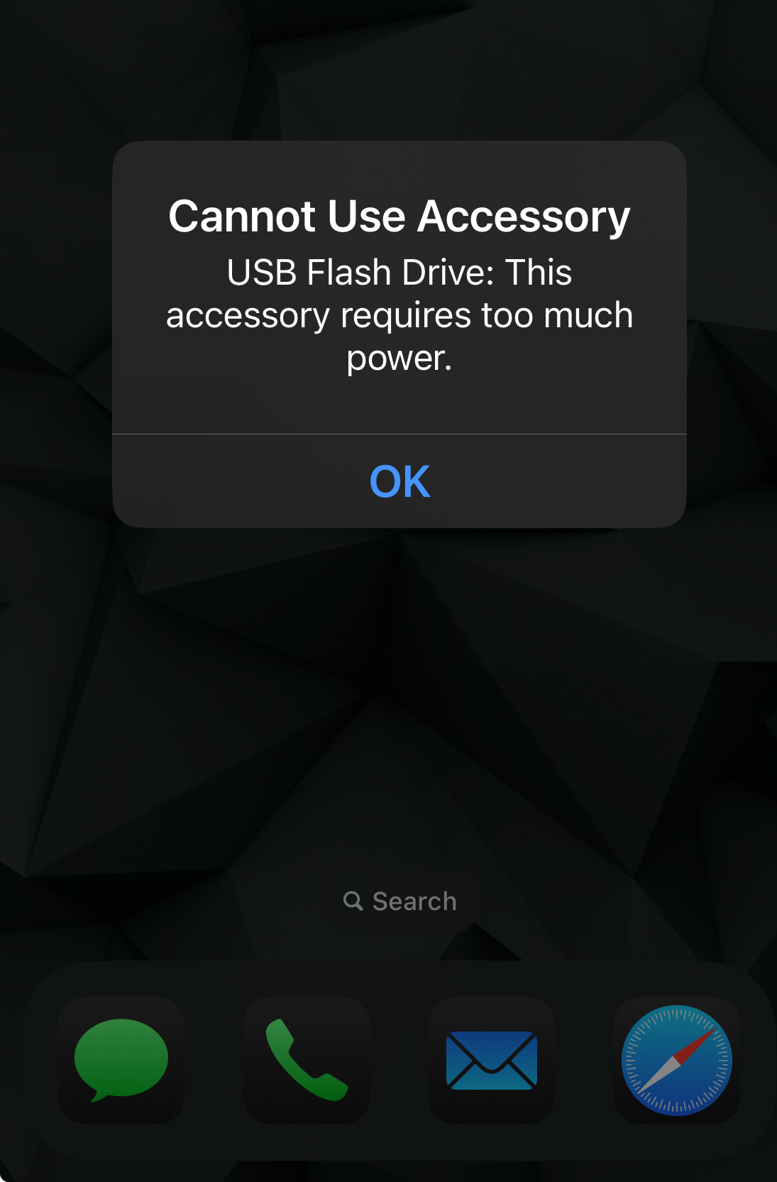

Also might be a problem with the dongle itself. If I plug into my 13 Mini with the Apple camera dongle, get a too much power message if not connected to a power brick. Seem to recall some older iOS versions did not provide the message, just never saw anything connected.
ADD: seem to recall a thread from the past where a person was having issues when daisy-chaining cables/adapters. Non Made for iPhone cables caused problems, and when "legit" cables, the daisy-chaining could be an issue in that it seems as there is no pass-thru of certification info (ie. cable plugged into iPhone sees that that cable is MFI, but phone does not see the MFI status for the cable plugged into the cable in the phone).

I saw a thread on the Apple forum, where someone with a phone the same model as mine was having the exact same issue. Apparently the iPhone 13 no longer supplies power out the port to USB drives. I’ll see if I can find a device with external power that I can use.
The Apple lightning - USB adapter I have has an (lightning) input for power, so you plug a lightning power cable into it, plug the adapter into the phone, and then plug your USB device that wants juice into the USB port. Does your adapter have the same?
I ordered one as an experiment. The weird thing is one of the drives that had an integral lightning connector worked on the identical model phone, same OS, but not mine. I did find one that worked, weirdness was it was
darned rescue cat stepped on my keyboard and posted before I was done. Lol. As I was saying, the weird thing is I tried a drive in another phone but the drive was Mac OS Exctended. According to Sun, eXFat/Fat/APFS all should work. At any rate,I'm going to take the same drive that worked, backup the data, reformat to a different type and see if that works, as an experiment. I'll keep experimenting for a day or two. If I still can't get it to work the way I need, I'll just use my android. Thanks for the response, btw.

I think I found the problem. It can't read exFat, but CAN read the Mac OS extended. I erased an existing USB to Mac OS extended when it was fat32 and the phone can read it now. Weird. NOTE: The OS version was one patch behind, which shouldn't have caused the problem, but I'm letting it patch now. I'll try again. BUT if I cant use exFAT for some reason, I'll just switch to an Android device.
Should work with exFAT. Files supports it, my thumbdrives are all exFat and are usable on iOS.
