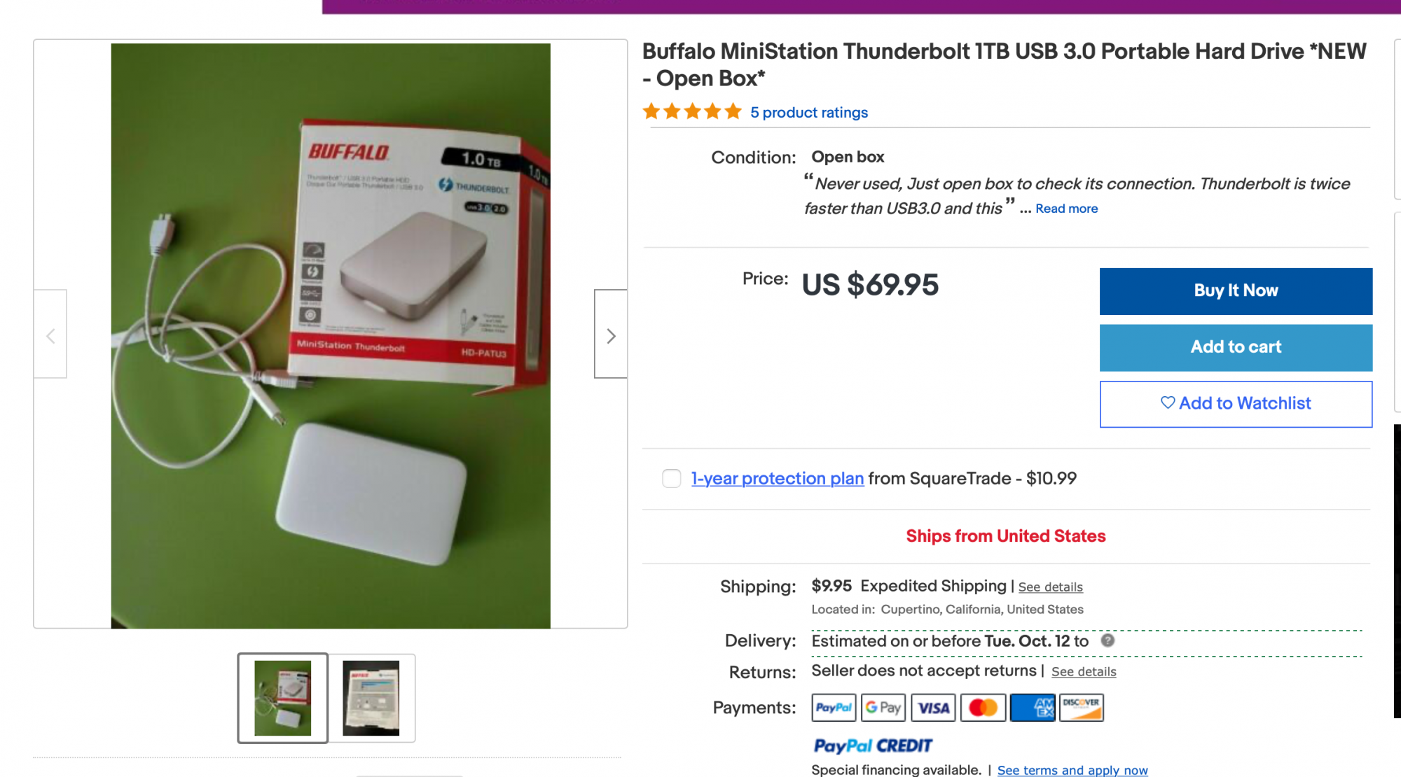

Would this one work? I don't want to buy one if I cannot replace the spinning drives with SSD

OP wrote in 13 above:
"Would this one work? I don't want to buy one if I cannot replace the spinning drives with SSD"
That looks to be a platter-based drive.
By the time you spend the money for that ($70) AND buy an SSD, you're spending WAY too much for "what you're going to end up with".
