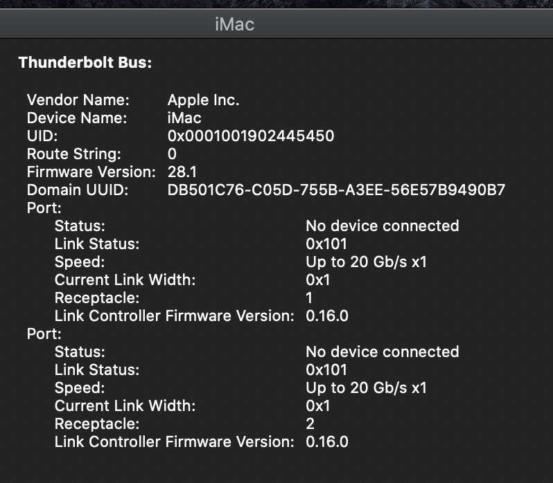

Hi,
I've got an issue with both the thunderbolt2 ports on my iMac (Retina 5K, 27-inch, Late 2015 Running Catalina. (Model 17,1)
I have an OWC Thunderbolt 2 hard drive dock that isn't connecting to the iMac over thunderbolt 2. It can connect via USB3.0, but it is much slower and isn't able to handle the video editing loads I require from thunderbolt 2.
Initially, I thought it was the cable, but the replacement cable didn't yield any positive results.
Next I assumed Dock's thunderbolt ports that had gone bust, but they work when connected to a MBP 13" via the Thunderbolt 2 to 3 Adapter that Apple sells.
So it's safe to assume it's the iMac ports that are stuffed right?
NOPE.
I plugged in an external monitor to both ports and the Display Port function is working fine and dandy.
I have reset NVRAM, SMC (multiple times) to no avail, and have run several diagnostic reports which have all returned with no issues.
Do I have a firmware/system issue with the thunderbolt 2/DisplayPort ports? Perhaps from the latest Catalina update? (I've attached screenshots below of relevant system info)
Would have taken it into Apple store but we've still got another 3 weeks left of stage 4 lockdowns (potentially extended to 5...) so that will be off the table for a while yet.
Thanks in advance for any assistance/pointing in the right direction!!

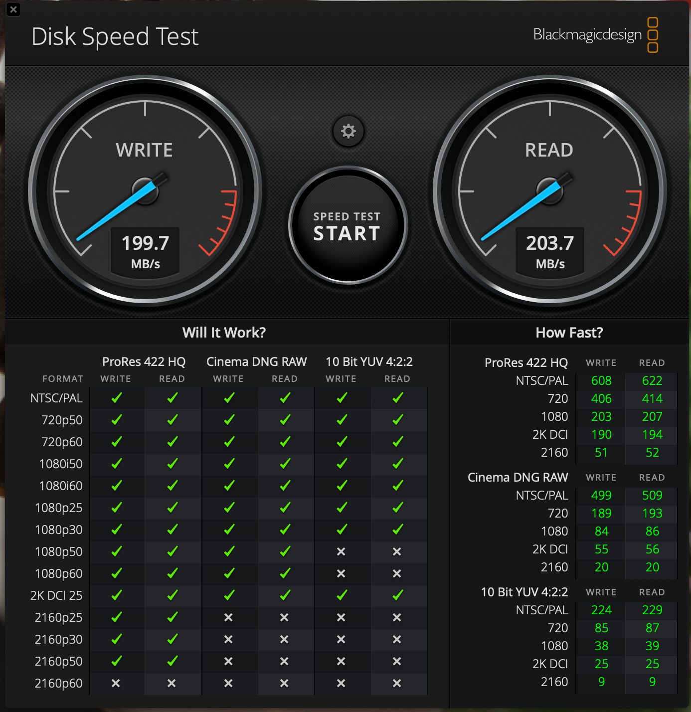

What are your read/write speeds RIGHT NOW using USB3?
Post those for proof of speed.
You tested the DisplayPort functionality of the Thunderbolt 2 ports. Try a different Thunderbolt device to test the Thunderbolt functionality of the Thunderbolt 2 ports?

Attached below are the speed test results over usb3.
Something else I've noticed is that the OWC drive dock occasionally disconnects randomly for no apparent reason over usb3. I may be reverting back to suspecting a driver issue on the dock's end now....
Yes, this is the next step - just that I don't have anything else other than the OWC drive dock.
Just tried to connect a Samsung t5 via the t2-t3 adapter but realised that adapter can't supply bus power...
Perhaps this is a good time get a thunderbolt port dock for 'testing' purposes too now...
