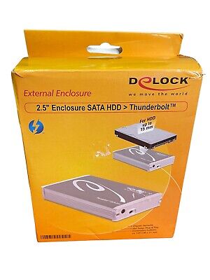

I've been using a Delock 42510 Thunderbolt 2 enclosure for almost 10 years now and it's still going strong.
I originally used it to boot my Late 2013 iMac. I loved it so much I bought Apple's overpriced TB3 to TB2 adapter cable to keep using it with my 2017 iMac and am still using it to this day for daily CCC clone backups.
It is still out there. You can get one here:
If you don't mind a beaten up box you could save $15 on eBay.

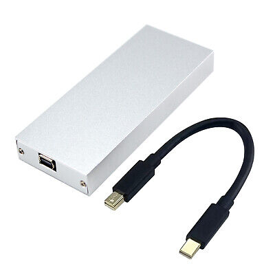

Just stumbled on this item on eBay, a Thunderbolt 2 NVME enclosure:
https://www.ebay.com/itm/235699106301
Described as:
Thunderbolt 2 M.2 NVMe External SSD Enclosure For iMac No disassembly required
The item is no-name, and the description ends with the following strange statement:
"This device only supports Kioxia and WD M.2 NVMe SSDs"
The seller proposes as well the enclosure with NVME inside 500GB -> 2TB.
PS: Sent from Wuhan, China.
I found out it's also sold on Amazon US. Amazon ASIN: B0DHLB1YMN.
Seems slow for TB2. Should be around 1400. The listing does not show the side of the pcb with the controller so I cannot determine which controller is used.
Indeed, it seems slow. About twice as fast as using USB3. The convenience is the main point, but it's not cheap.
