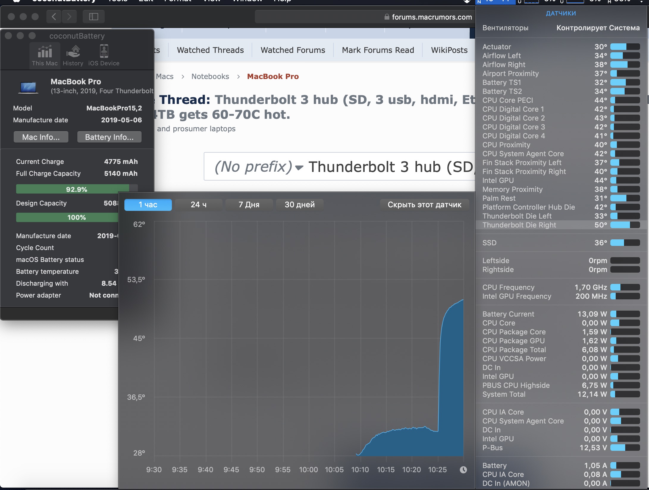

I have recently purchased a Dynamode (8 in 1 hub) to use my quite old Samsung SymcMaster 21" external display. It is connected to my hub via DVI-HDMI cable. It has 2 types of SD cards, 3 USB 3.1, 1 Ethernet up to 1 Gbit, HDMI and USB-C power port.
As soon as I connect hub to MacBook the temperature of Thunderbolt die sensor rises from 35 to 50, if I connect my 1080p display it rises from 32C to 50-60C Celsius degrees on thunderbolt die (depending on what is connected to the hub). The hub metal enclosure itself also gets hot up to 40-45 degrees. But I am not so worried about my hub, I am worried about my MacBook. It’s cpu zone gets significantly hotter, CPU\GPU sensors show 60-68 degrees for CPU/GPU wile its use is within 10-18% stable.

There isn't "cheap" Thunderbolt hubs, that is a USB-C hub. TB3 hubs are 10x that price and offer a lot more performance.
However what you are experiencing is normal. The Mac is now powering and controlling that hub. 5-10 watts is not abnormal merely plugging a hub in.
Here is my USB C hub (HooToo M# HT-UC008) I carry around which is has 2 x SD Card readers, 1 x 4k 30hz HDMI, 3 x USB 3 and 1 x gigabit ethernet.
That is with NOTHING plugged into it, no HDMI, no USB, no ethernet, etc. Plugging accessories in can further increase the processing and power requirements and increase temps further.
If you are using all those USB-C hub ports then its required. I use a hub at work and home to connect external display, ethernet, and power via one cable. Plugging directly into the Mac via a thunderbolt 3 cable to HDMI (for example) is a more efficient way to connect because the Mac doesn't need to power external controllers.
CPU/GPU temps will rise due to the required additional processing via thunderbolt 3. Its hard to compare to your MacBook Air without knowing it was doing the same exact thing (1080p 30hz vs 1080p 60hz is effectively half the bandwidth).
4k will naturally have higher temps due to increased processing requirements on the CPU/GPU and higher bandwidth requirements through PCI > TB. 4k 30hz 8 bit I see 55-65c, 4k 60hz 10 bit (HDR range) I see 90c+.
