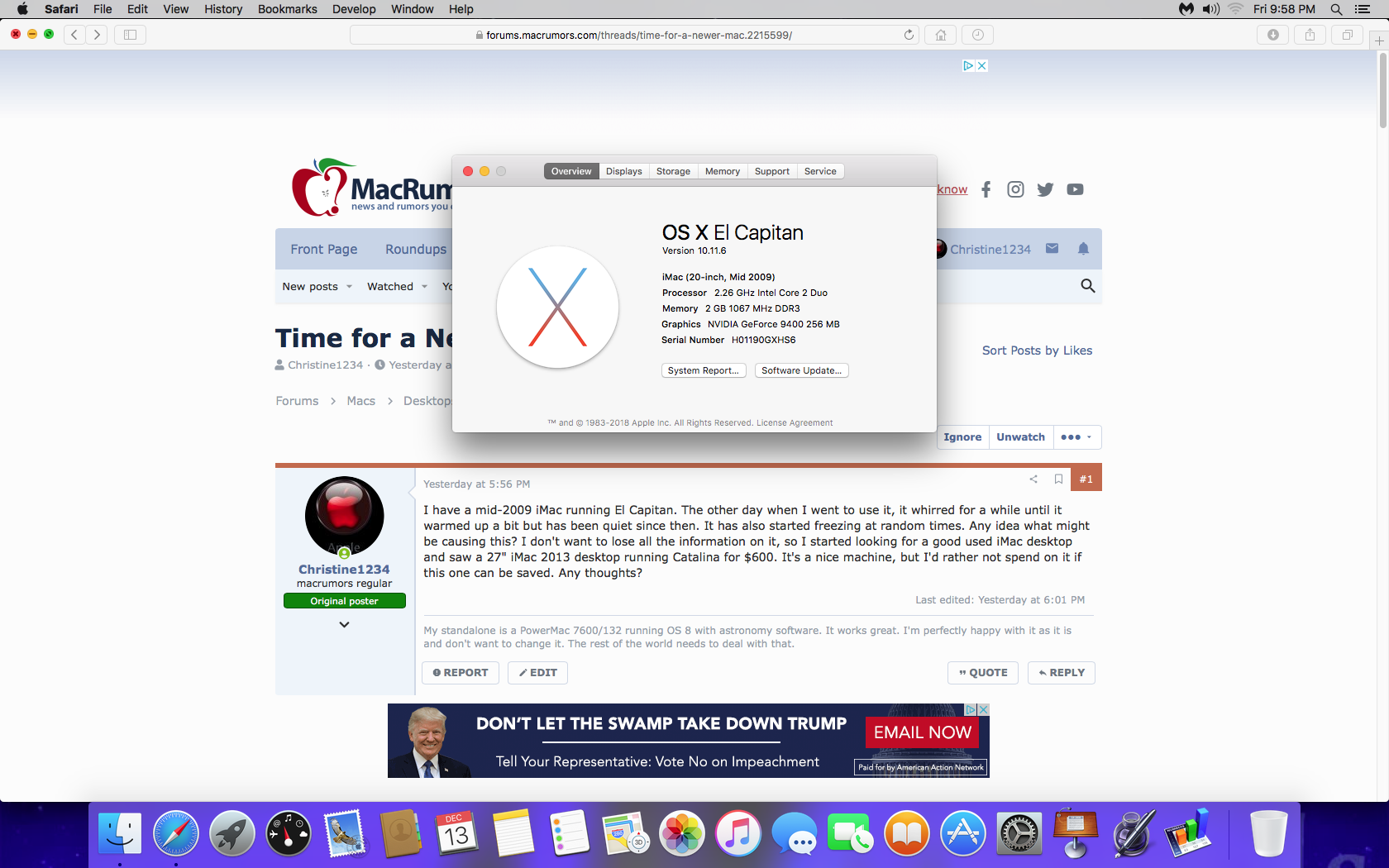

I have a mid-2009 iMac running El Capitan. The other day when I went to use it, it whirred for a while until it warmed up a bit but has been quiet since then. It has also started freezing at random times. Any idea what might be causing this? I don't want to lose all the information on it, so I started looking for a good used iMac desktop and saw a 27" iMac 2013 desktop running Catalina for $600. It's a nice machine, but I'd rather not spend on it if this one can be saved. Any thoughts?

It says 240 GB solid state SATA drive, but I don't see a model number. I don't know how to do the picture, but it says iMac 20 inch mid-2009.
Is this it? Model: WDC WDS240G2G0A-00JH30
