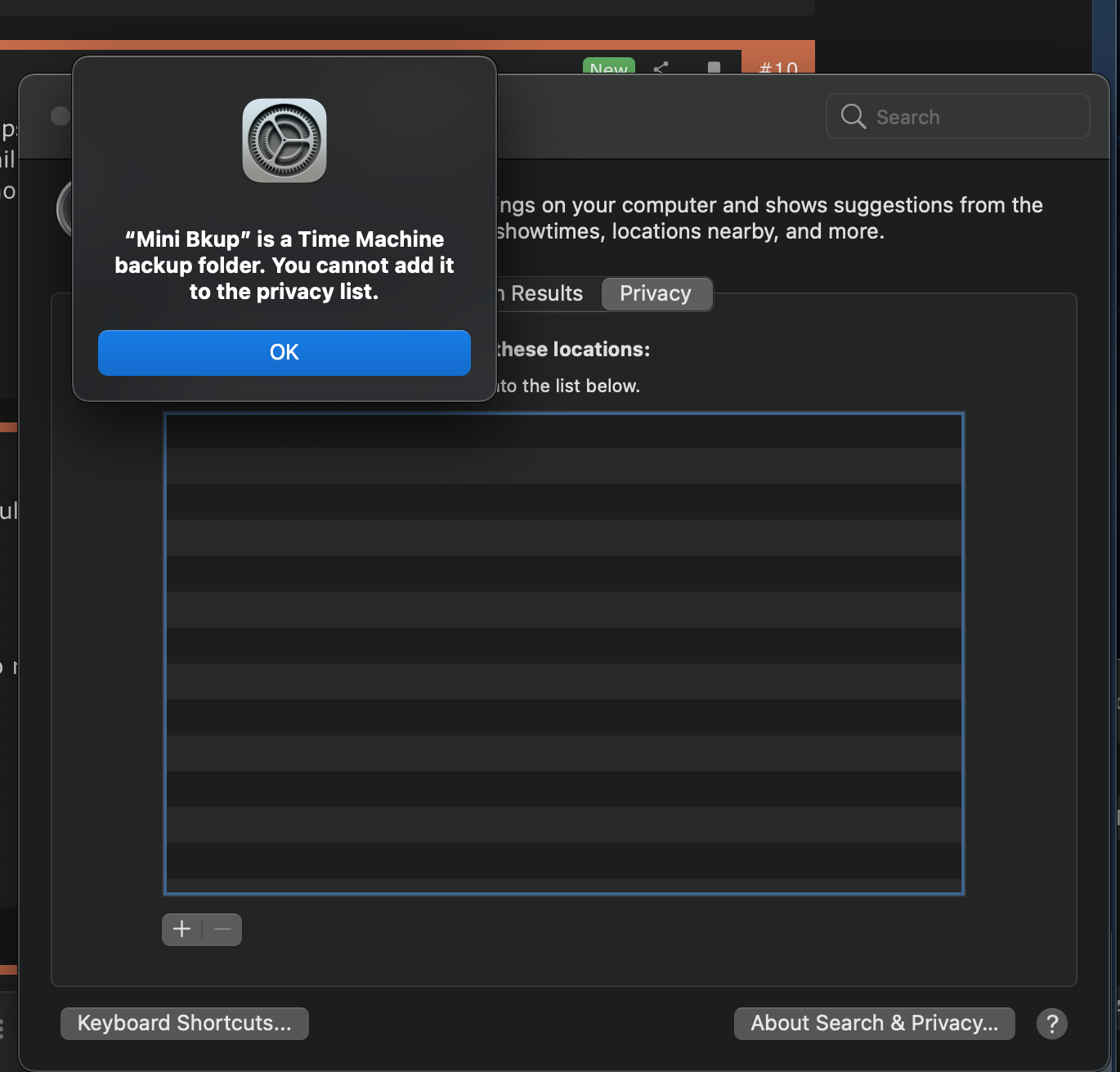

What exactly is mentioned as the cause of the error ?.
Thanks for the follow-up. The only detail when the box pops up is: "An error occurred while preparing the backup." Nothing else. I did attach the Log report that I ran following the failed backup. Not sure if that will help. This is the most frustrating thing about the error. There's not much information and no specific error number or anything like that. Thanks for your help.
According to the report, Spotlight seems to be the main culprit for the issue.
Let's try to exclude the Time Machine disk from indexing.
1. In System Preferences open Spotlight.
2. Drag the TM disk icon to the Privacy window.
3. Click on it an and click the minus sign on the bottom to remove it (you may be asked to authenticate), so that the disk is not further indexed.
Any luck ?
Any luck ?
Sorry, have been away for a few days. I tried this procedure but received the same error message. Just for clarification, I added the disk and then pressed (-) before trying the backup. Was I supposed to try the backup in between step 2 and 3? After step 3 the icon disappeared and the box appeared as it had in Step 1. Thanks.
