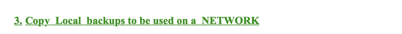

Scroll down to section 3. at this link and it will walk you through how to make a USB TM backup, then transfer that to the Time Capsule.
Reactions: sonnenhund
@Weaselboy, I believe that is out-of-date for Catalina. Time Machine now creates backupbundle files, not sparsebundle - and these are quite different. backupbundle files are not mountable, but can be opened. And inside them I could not find a Backups.backupdb file anywhere. So I ended up having to do the full ~950GB over the network anyway...
Reactions: Weaselboy
Interesting.... first I have heard that. Thanks
The backupbundle file is actually a sparsebundle file. On one of my Time Machine backup drives I have a backupbundle file which was a Time Machine network backup. I added the extension .sparsebundle, it became mountable and I was able to access the Backups.backupd folder inside.
