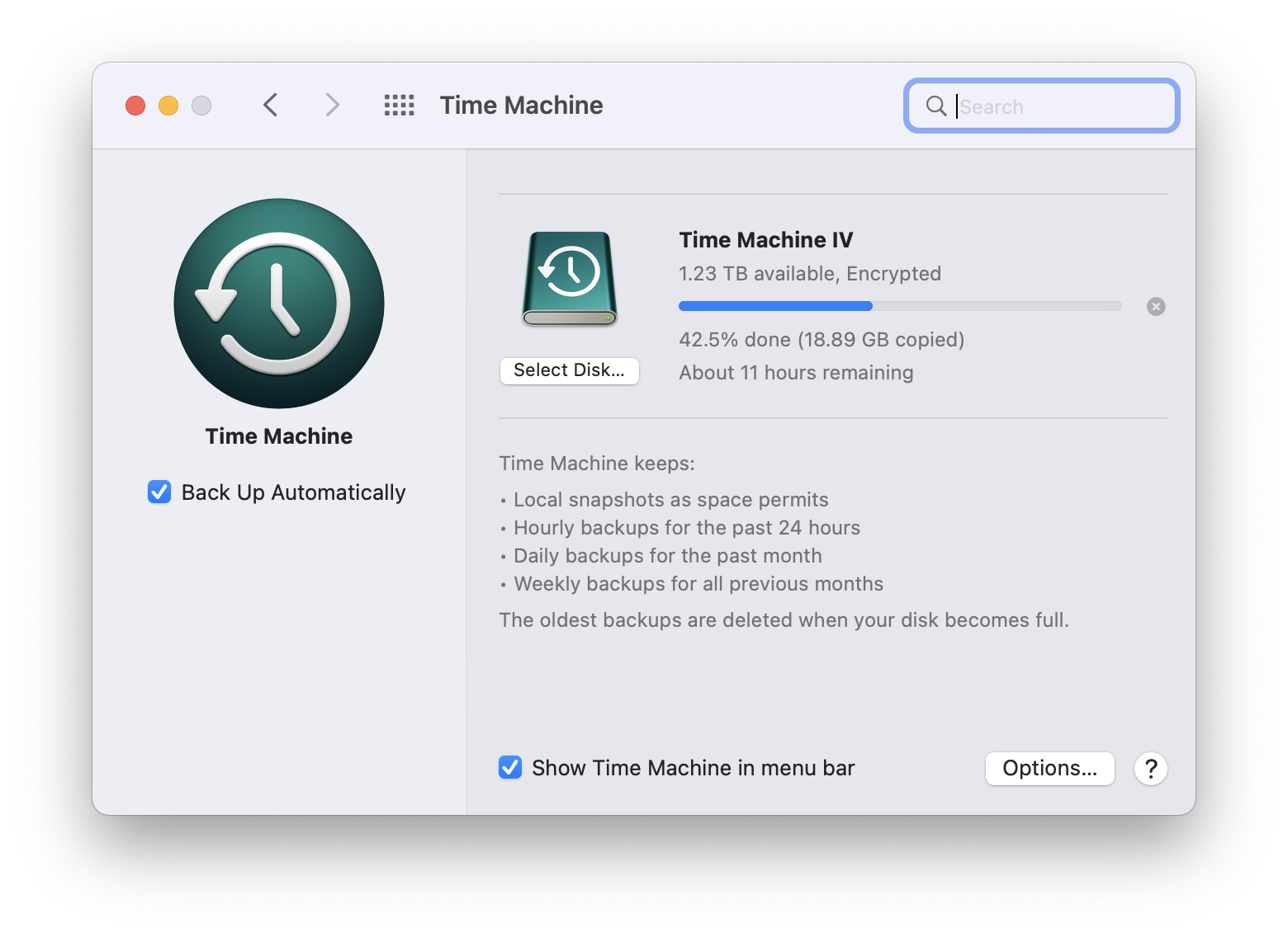

I've had this happen too. Backups start and then silently don't complete themselves. I looked today and didn't have a backup any more recent than two days ago and initiated one manually via the menu bar icon. And now it's backing up insanely slowly. Going off this, it's gonna take 11 hours to back up ~20GB of stuff. This is a portable USB drive connected directly, btw, nothing over wifi.
