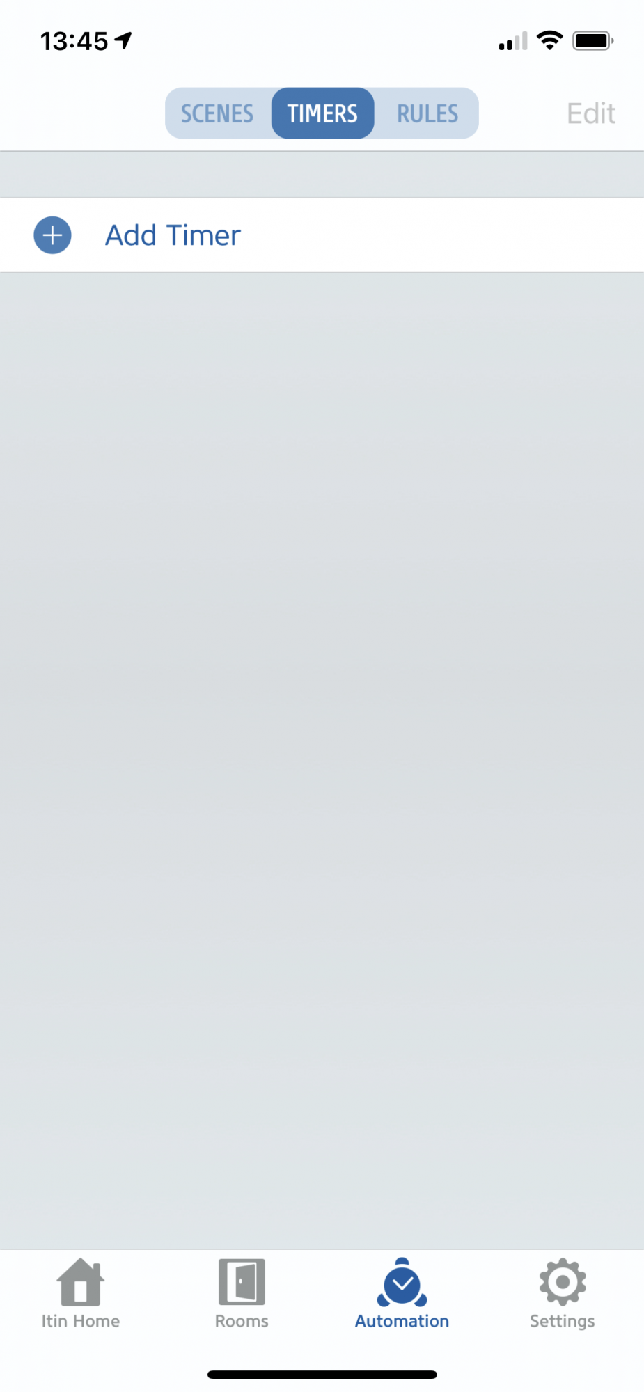

I think you can using the Controller for HomeKit App. Link but I'm not sure if those are part of the In-App Purchase?
I have not used it so I'm going off my memory when reading about it. Here is the Web Site Link
You can create time based automations
Is this not a timer?
No it’s not. Kind of mislabeled as it doesn’t give you what typically a ‘timer’ is (countdown). It’s just a scheduler based on the tinkering with it I just did. Bummer. I got excited
Ah ok, thought you may have missed that when you were poking around. Sorry, I haven’t played with timers before so not too familiar on what they are or do. Just went on what I saw.
