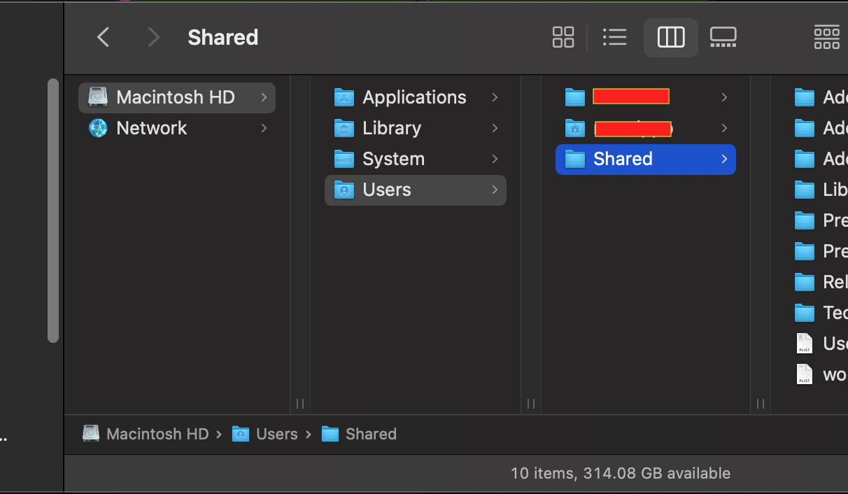

Have 2 shared folders :
(1) /Macintosh HD/Users A1/Shared/ when booting from A1 and
(2) /Macintosh HD/Users A2/Shared/ when booting from A2.
Therefore, can only move data folders to the same Shared folder i.e. A1 data folders to A1 Shared folder and A2 data folders to A1 Shared folder. Using external SSD is the only way to switch the folders. Does it make sense?
The Shared folder we were talking about is not inside any user folder....it lives inside the Users folder:

Thanks everyone! I deleted one user after data transfer. Now it looks OK so far.
