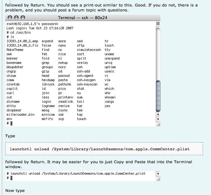

6). When I try to upgrade to 1.1.1, where I am writing in terminal, I do not get the string of words and it just states command not found. (please infer on the picture attached to this post with command line on the first picture. That is the IDEAL COMMAND LINE, I DON'T Get this on my phone!).
