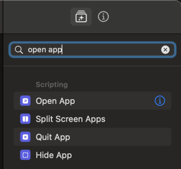

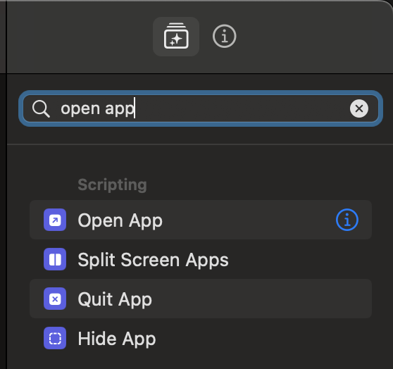

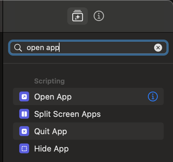

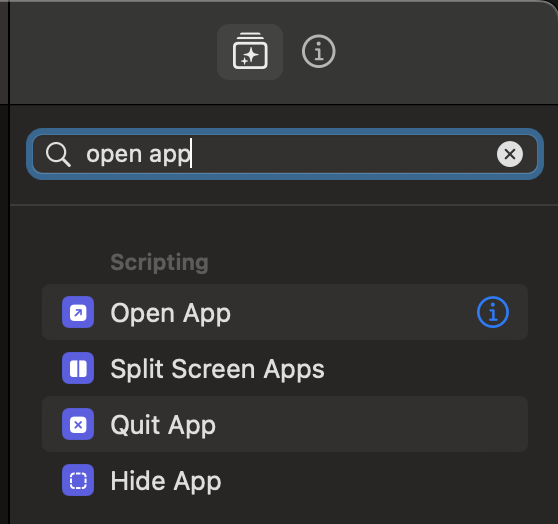

Then would need to use "Open App" Action to launch Zoom.
