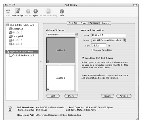

In short, this is the most important thing for OS 9. I've never actually had a clear understanding how this works, but without it, OS 9 will just not so much as be able to read the drive. It'll always be installed if you partition using OS 9.
This option "Install Mac OS 9 Disk Driver" is never visible for the internal drive of the G4mini or any partition regardless what filesystem, no chance, tried everything. Tested Panther and Tiger....no chance. It's even without Morphos installed.

Huh, I should have read that article more clearly, it looks like Panther might be a little broken, actually.
This option is neither in Tiger on that machine for the internal drive of the Mac mini G4.
Have you completely redone the whole drive from scratch using Tiger's Disk Utility? Because once you break OS 9, you have to start over completely. There's no way around that.
Hmm, maybe the problem has to do with the fact the the Mini was never officially supported by OS 9? I wouldn't put it past Apple to not have OSX Disk Utilities to just not use OS 9 Drivers on Macs that don't support OS 9. But, if you set up all your partitions in OS 9, then the rest should just work, because in all my tinkering, formatting existing partitions never bothered anything, altering the partition layout did.
