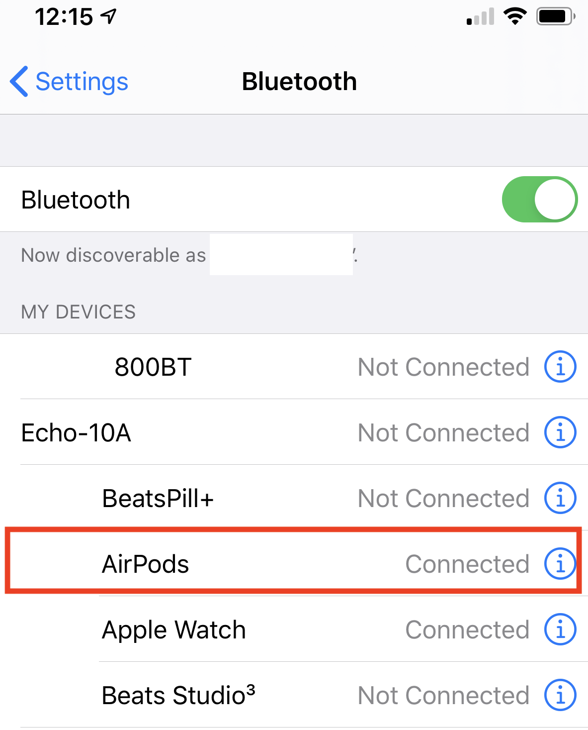

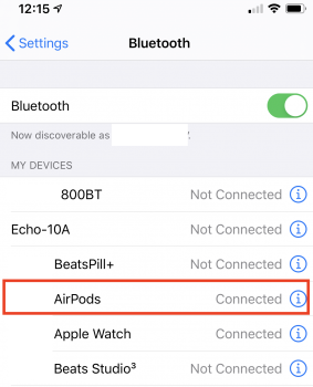

I’m a runner too and run into this a lot as well. Go into your bluetooth menu and tap on the AirPods. Then tap Disconnect.
The H1 chip makes it so that you don’t have to unpair and pair when you want to use a new device. However, you still need to disconnect and connect.

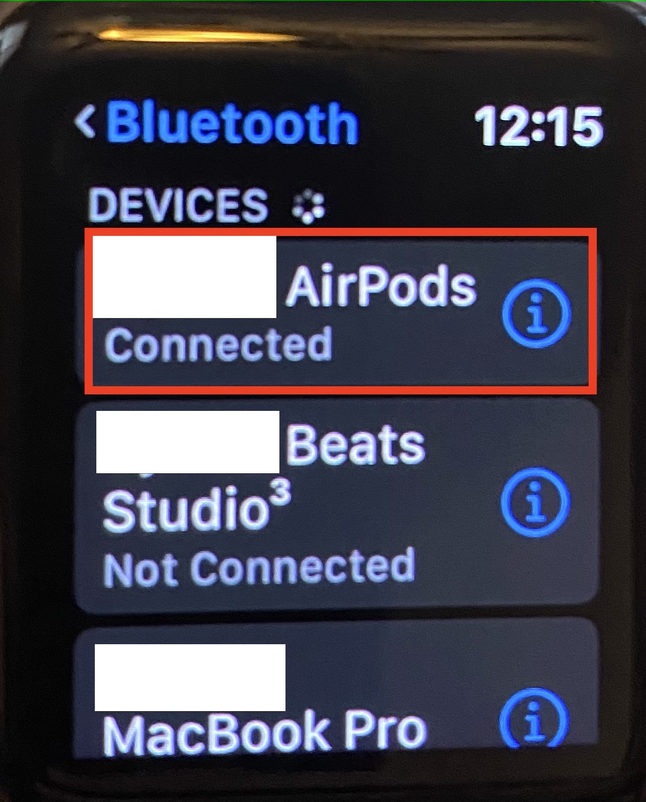

They will connect to both the watch and the phone at the same time if they are paired. AirPods are the same way....
Audio will play from both by pausing the first one and playing the second. Ex. iPhone is playing audio from a video, if you play a song from the watch it will pause the video and play the song from the watch.
