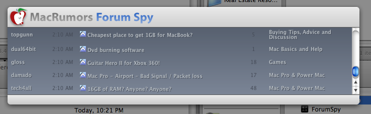

I'm trying to get a working Forum Spy widget going. It works fine in testing in Safari, but I am having problems with the interaction of the scrollable area. When you try to use the scrollbar in the dashboard environment, it is taken over by the 'drag this widget around' code. Same seems to be the case with all links. Everything works fine testing in Safari, but not when I get into dashboard.
Can anybody contribute a little wisdom on this? I feel like I am really close. Admittedly I am more of a designer and less of a programmer...
UPDATE:: Thanks to Lixivial's troubleshooting the link issue, the widget is fully functioning! Download the working widget here:
ForumSpy Widget

UPDATE:
I was able to fix the scrolling issue. I have updated the file above. All I need help with now is how to get the links to work! :confused:
Again, they all work fine in safari, just not in dashboard.

If anybody looks at the widget source, they'll see there is special script necessary to get a link to exit dashboard. (Like on the back of the widget). My problem is the links in the spy are dumped in from the server script. I'm not sure how to 'wrap' them in the script necessary to allow the link to exit the dashboard. :confused:

Well, decksnap, the first problem is that you were referencing MacRumors' javascript file. This would be fine if the widget didn't require a special function to open URLs; being that widgets require, (as you're well aware, I'm sure) widget.openURL as their function, and being that MacRumors' javascript file is accommodating standard HTML, herein lies the problem.
I modified your ForumSpy.html to accommodate a modified version of the javascript file that MacRumors uses. I tossed the copied stuff from spy1.2.js (MR's remote file) into forumspy.js (the widget's local file) (so that we can modify the javascript to use widget.openURL(); ) at the very bottom and modified the relevant portions (namely just appending widget.openURL(" "); to the portions that open/generate the links).
Now, um, it's up to arn/MR to decide whether or not copying/modifying their javascript is allowed...
Being that the file was 2KB more than the allowed attachment size, I have to host it elsewhere; so, here... **link updated in decksnap's original post **
I did some brief testing on my iMac and MacBook, and it seemed to work.
Well holy ****** ****. You rock! It appears to work on my end. I'll get it hosted up later... maybe wait around and see if anybody has a problem with the js usage. I am suspecting not, as it just drives traffic to MR anyway.
