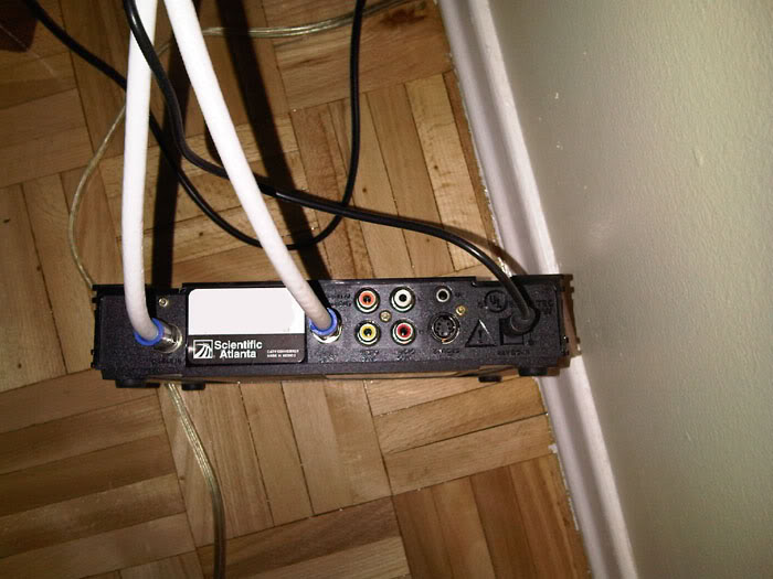

Here is the picture of the back of my digital terminal.
It's a Scientif Atlanta Explorer E940. I see something that looks like a S-video plug and I am not sure what is on top of that. As for the colored plugs, I assume for a Xbox, PS3 or other console.

If you're just going to use it to watch live TV, I still don't see why you can't use the the EyeTV One.
Your Moto STB has a white coax cable going into it from the wall. AFAIK, the other white coax cable would normally go to your TV. In your case, it'd go into the EyeTV one.
When you want to watch TV, you'd start up the EyeTV app on your Mac, and tune it to channel 3/4 (whichever one your Moto STB outputs on). You'd always leave EyeTV set to that channel, and you'd change TV stations by using the remote for the Moto STB. This setup defeats using the cool EyeTV app as a DVR, since your Mac can't automatically change the channel on the Moto STB (although there may be some infra-red add-on you could buy that might be able to do that).

Digital TV in Canada tends to be encrypted, hence the STB. COAXs are often disabled for output.

The orange plug is digital audio out, the yellow is composite video, the red and white are audio, the small one above the s-video is the infrared extender jack. As suggested you can use the coax to go to the eyetv or any other type of USB tuner or you can use a compatible USB video capture card to get the s-video/composite and stereo audio.
