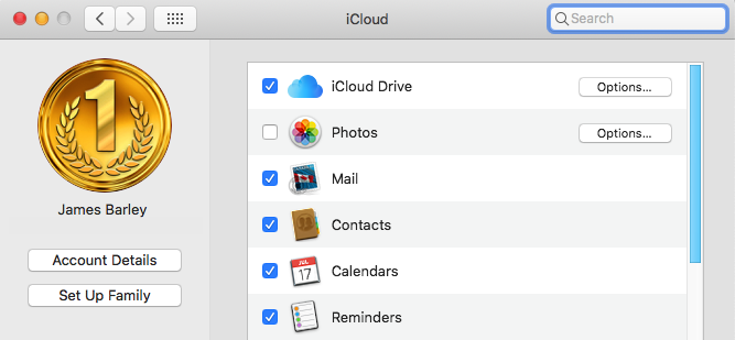

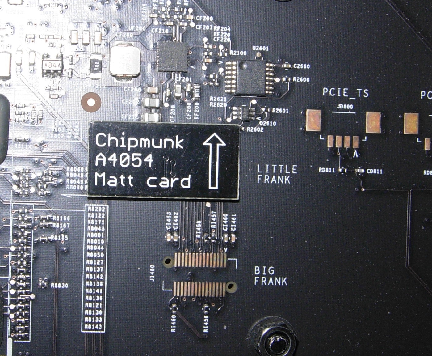

Like you I also had my MacPro 4,1/5,1 fail to boot shortly after it was flashed.
I ordered a Matt card and it was a simple plug and play, computer was up and running minutes after the Matt card arrived.
There was no flashing/programming required on my part.
My system uses icloud without any issues, as to imessage and facetime I can't comment, never used them.
Again, just plugged in the Matt card and it booted,would definitely purchase another if the need ever arises.

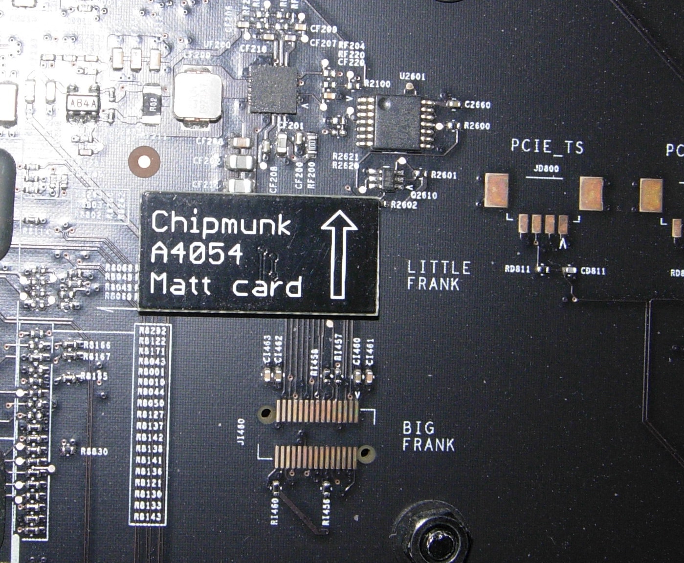

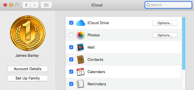

Don't assume that something that works for your will work for everyone. Apple will block iCloud/iMessage/FaceTime from your Mac Pro the next time a clean up is done. It's a clone of GJ0340TXH2N, this is not difficult to understand the implications.
I wasn't assuming anything, only expressing my personal experience.
My system has been running flawlessly using the Matt Card since I installed it in Nov 2020.
When or if Apple screws it up, then I'll deal with it.
Look, even if you are not assuming anything, you are writing that works perfectly for you and this validate it for someone that have less knowledge/don't understand the implications.
Apple periodically validate iCloud/Messages/FaceTime logins and even real Macs with real/valid/correct SSNs sometimes are blocked because a technician forgets to include one of the hardwareIDs during a repair or something along the lines like don't adding a SON to GSK and then the user have to open a request to whitelist the Mac within Apple database.
Clones are even more scrutinized that hackintoshes.

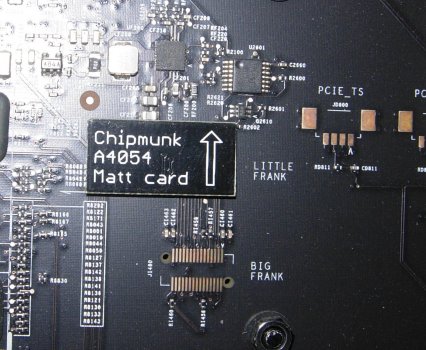

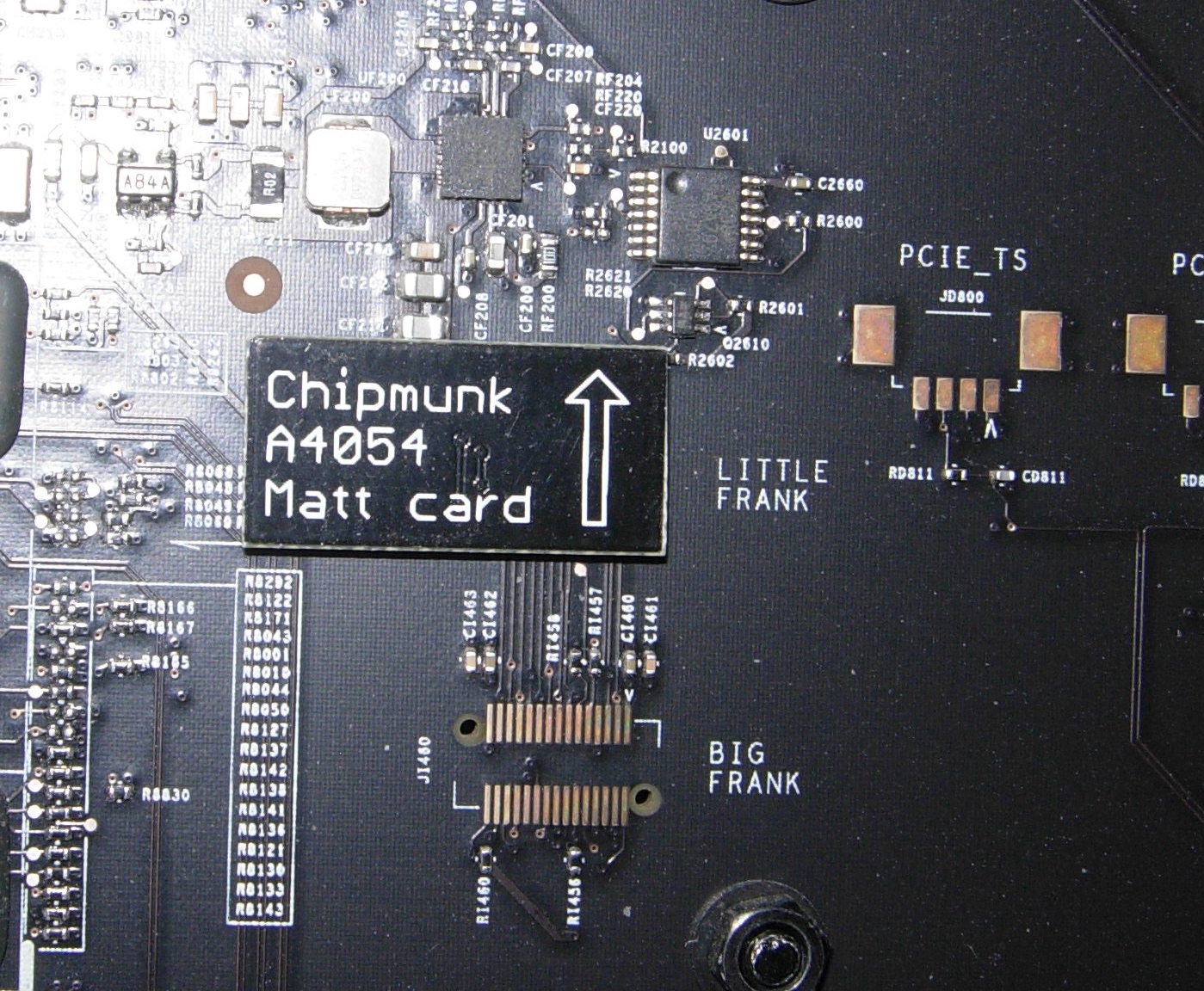

View attachment 1806241View attachment 1806235

If I remember correctly mine powered on (white power indicator light on) but nothing else.
Just sat there doing nothing.
They only offer 1 unit for 3 different Classic Mac Pro models,(2009, 2010, 2012) so ordering is simple.
My unit had been running as a 5,1 flashed from a 4,1 for a short period before it failed,
so when the Matt card was installed it booted as a 5,1.
