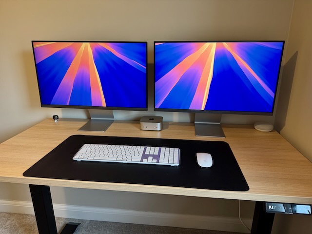

Hi all,
I've just bought and set up a new M4 mac mini and two identical 27" 4K monitors.
One monitor looks perfect, the other is blurry and not being recognised as 4K. Any idea how I can fix this please?
Thanks,
Luke.

Hi,
The monitors are two identical MSI MD271UK's, one is connected directly by HDMI (that one looks fine) and the other is connected with an identical HDMI cable via a USB C adapter.
I've swapped the two monitors and get the same results on each of them so I don't think they're the problem. I'm thinking it's likely to be the USB C adapter thats the issue?

And what resolution and refresh rate does each one report on each connection?
Both 60 Hertz, the one connected directly shows as 4K resolution, the other shows as 1440p.
I bought the USB C adapter years ago for my macbook pro but looking at the listing, it shows as supporting 4K 30 Hertz.

Thanks for the advice.
I don't have any way to connect the second monitor directly to the mac mini as there's no second HDMI port and the only USB C cable I have is the one that came with my macbook charger. When I try that USB C cable, the monitor doesn't even recognise that the mac mini is connected.
Regardless of which monitor I connect directly with HDMI, that one looks fine and the other blurry so I know it's not the monitor.
I've connected the USB C hub and HDMI cable to my macbook and the screen is still blurry so it's not the mac mini.
That leaves either the hub or the HDMI being the problem. I don't have a second one of either so I'll need to buy a new cable. Probably best to just get a good USB C cable to connect directly right? (I don't need to use the hub at all).
