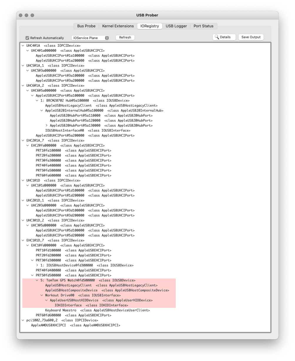

Here is, what USB Prober shows, if this is of any help:
So the watch seems to be "seen", but the Java-app is unable to access it.

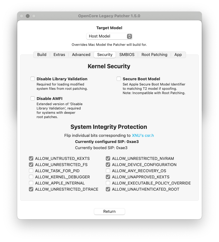

Also i did some adjustments to the SIP-settings with OCLP...
...to get the Kext to load.
