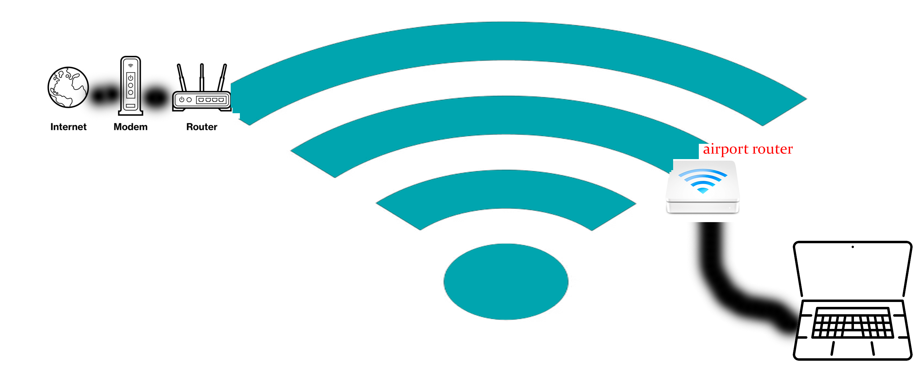

I have an old Macbook Pro in my bedroom that has been connected to my home network thru an Ethernet cable that snakes around the apartment. (Wifi seems to break bad on it in a way I could never solve, so just using ethernet wound up being easier.)
That cable became severed (in an unrepairable way) and rather than replacing it, I decided to try to set up a bridge using an Airport Extreme I recently acquired.This worked the way I wanted, with the Airport Extreme setting it up easily.

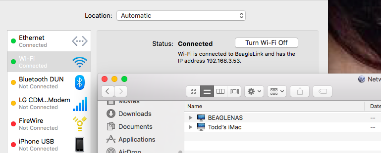

If I connect thru Ethernet, I do not see any of the computers on my network:
If I connect with the WiFi, other devices on the network show up:
I can then connect to them. IF I turn off WiFi after connecting to my iMac, I don't lose connection to the shared iMac folders.
(there are some windows computers not showing up here as well, but for now, I'm tackling just the mac part).

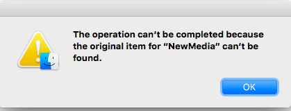

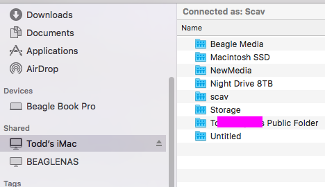

I can connect to the iMac's startup drive and internal storage drive (two seperate drives), but When I try to connect to any connected USB drives, I get an error "The operation can't be completed because the original item >drive name< can't be found.", despite the USB drives being listed as being there:
