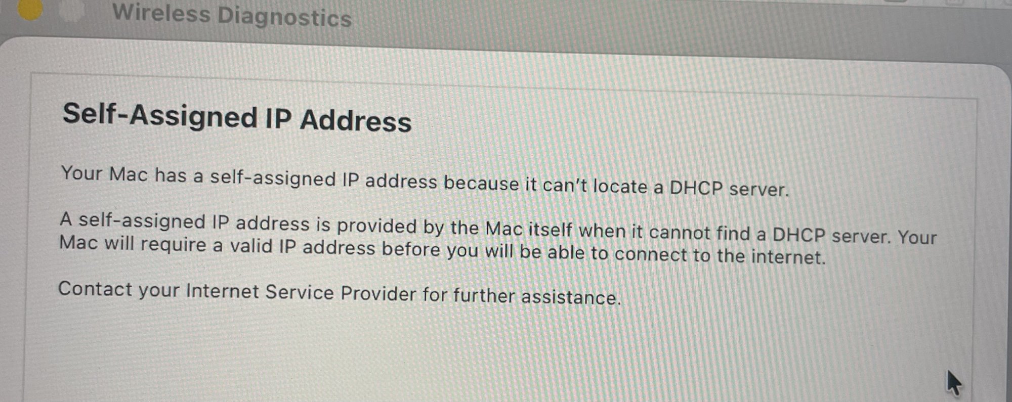

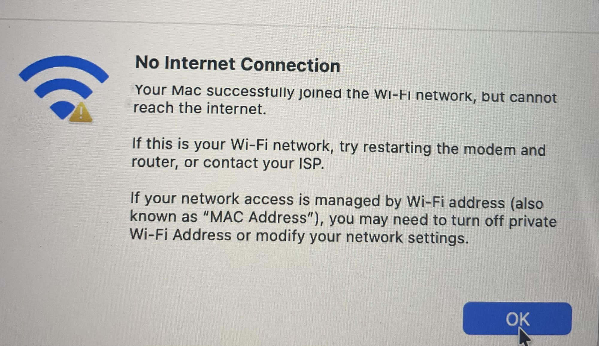

Thanks Ruggy I’ll try this now. On the mean time, I got this message

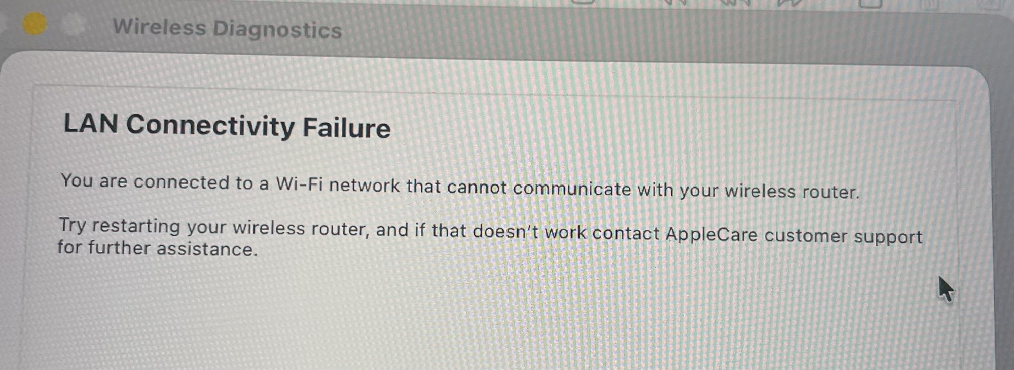

And diagnostic test completed and I have these issues. How can these be fixed? My WiFi is definitely working as all my other devices are working iPhones, Apple TV, PC laptop.

Thanks Fishrrman. I’ll try this when I’m home. In the meantime, what would cause this issue?
I’m home. Tried renewing the DHCP Lease. That didn’t work. I created new network. That didn’t work either. I’ve restarted the Mac and modem a 1000 times. Nothing is working.
There was a file I could’ve deleted but I don’t have that file.
Totally lost now and desperate as I have so much to do.
