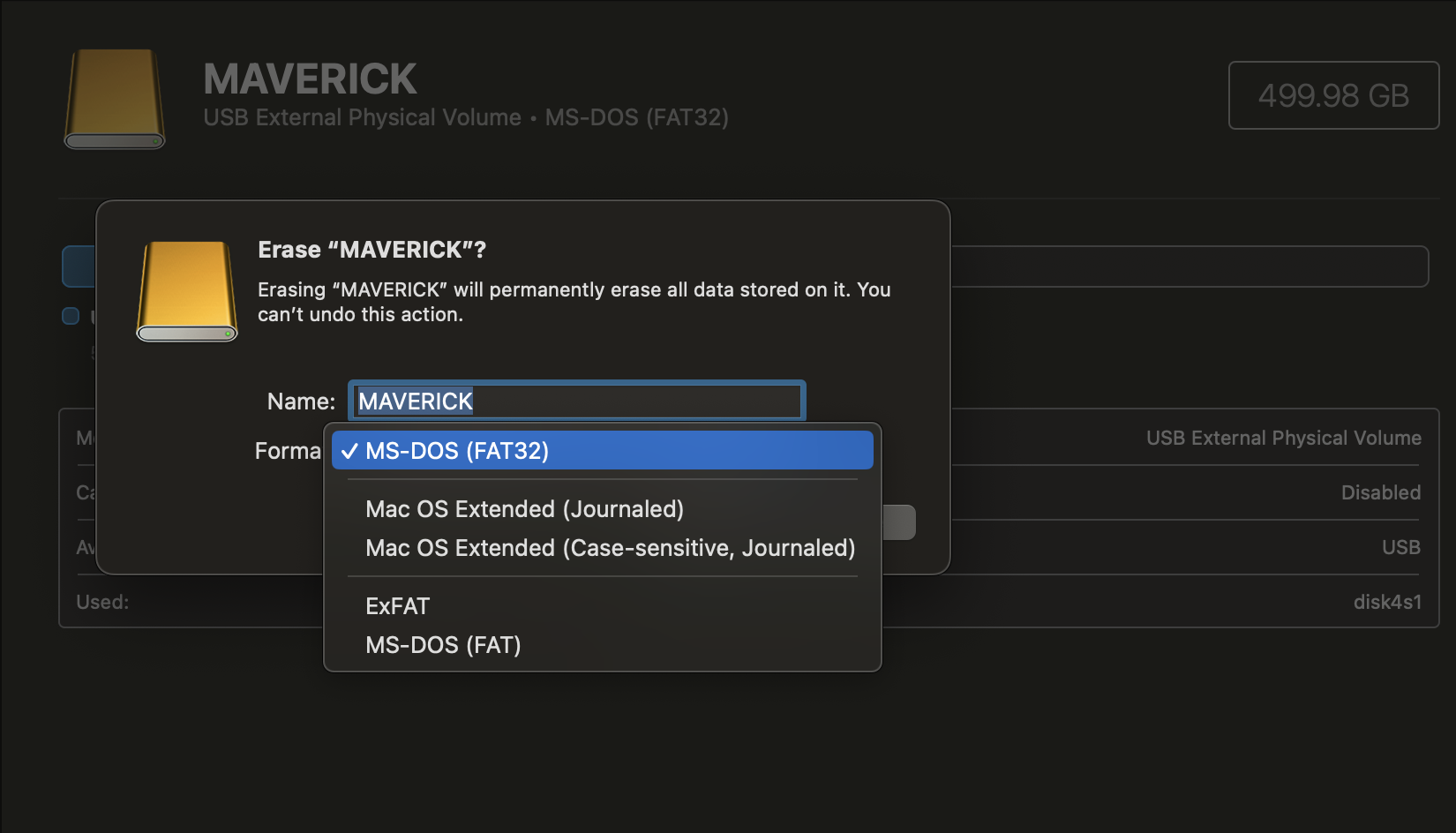

What is APFS? These are the only option I see while erasing.
That’s interesting. Idk why Apple doesn’t show APFS option. It should, whether the speed is good or not.

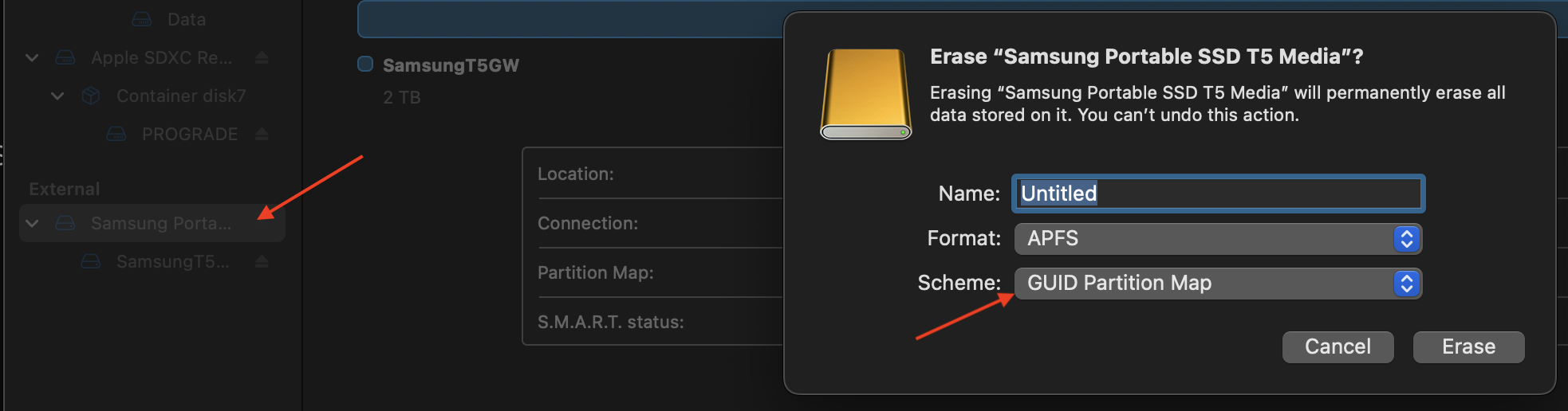

You just have to setup the settings correctly for APFS to show.
Select the right device (not the volume) in Disk Utility. Sonoma displays drives a bit more complicated than before by showing the device and its volumes. (If you don't see the same view as my screenshot, then click on View in the menubar and click Show All Devices.
Change the Scheme to GUID Partition
Once you change the Scheme, APFS options will appear.
