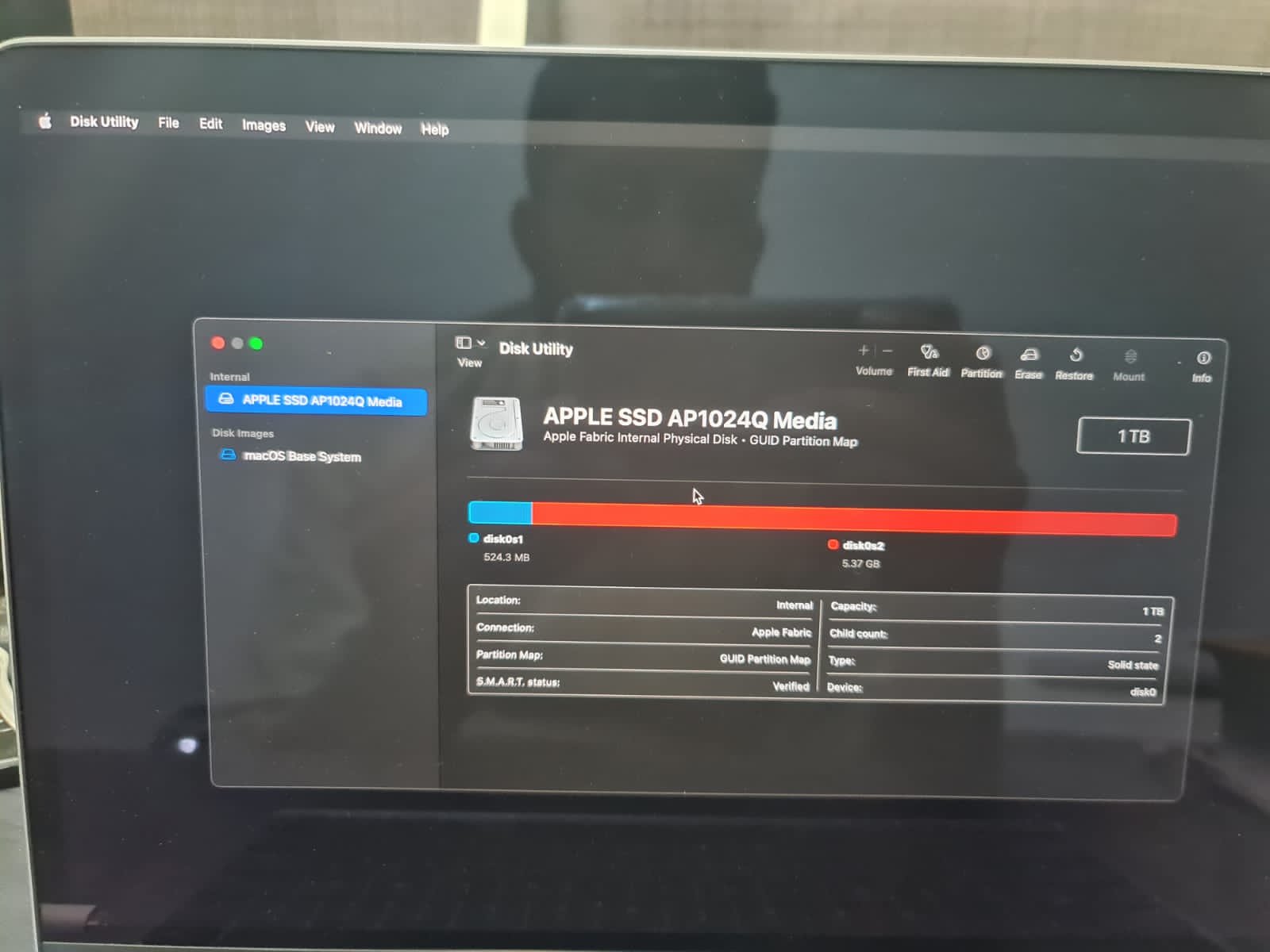

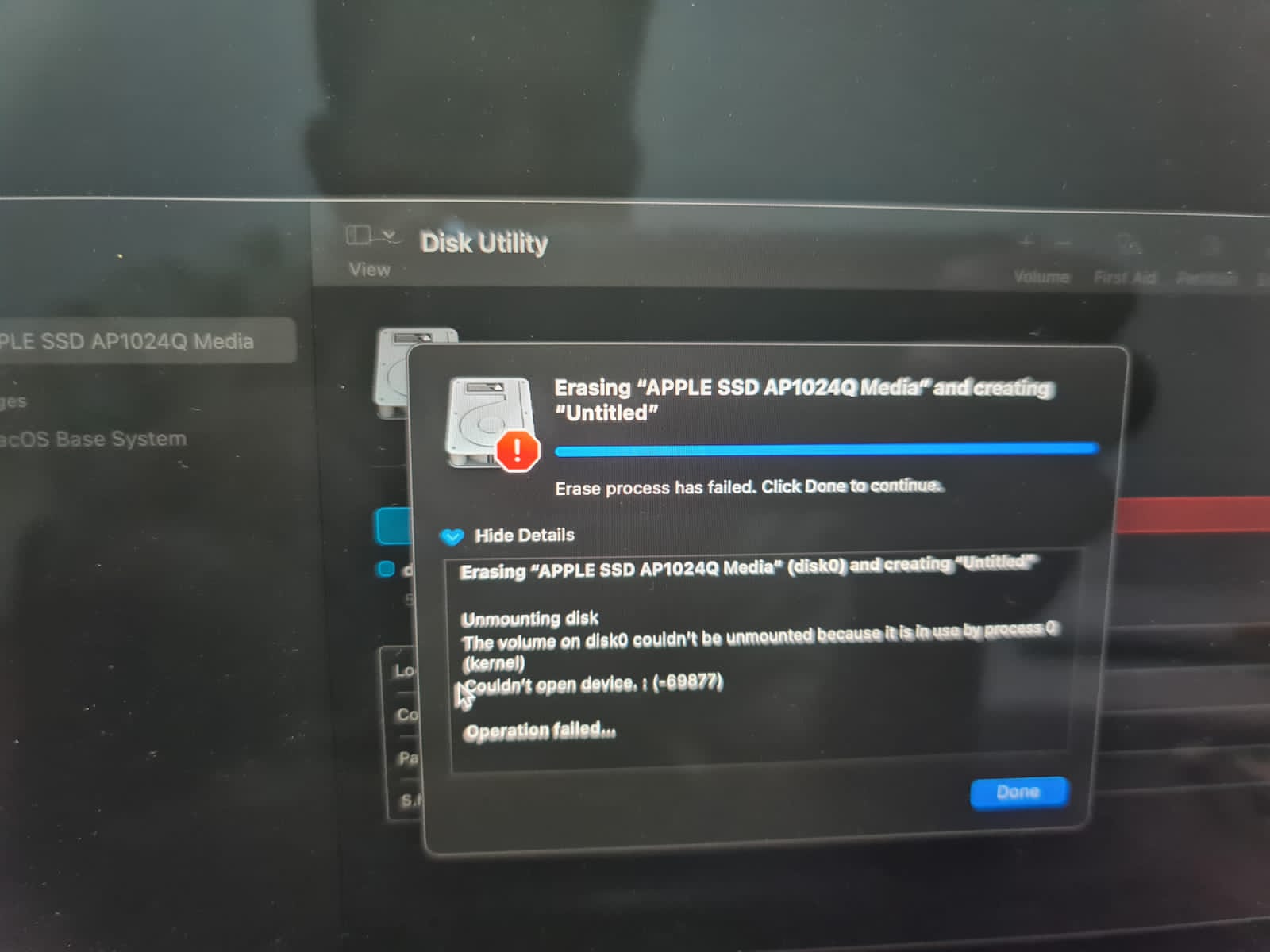

I’m unable to install anything because the disk doesn’t show up. I am unable to do anything to it. I’ve tried all tricks in the book. How to do it with Apple Configurator?
You're erasing the disk in APFS, right? This is so strange - looks like the kernel (process 0) is preventing the erase from happening at all.
Are you on Big Sur or Monterey? If on Big Sur, you should see an option up in the Apple menu to "Erase Mac." Have you tried that?
Now, to answer your question:
To erase/restore with Apple Configurator, you'll need:
  • Second Mac running Catalina 10.15.6 or later
    • Preferable for it to have a USB-C port (see below)
  • Access to the Internet
  • USB-C or USB-A cable - can use the charge cable that came with the MBP; must be able to transfer power and data. Thunderbolt cables aren't supported.
Use this link to see the instructions for how to enter DFU mode on your specific Mac: https://support.apple.com/guide/app...ore-a-mac-with-apple-silicon-apdd5f3c75ad/mac
Once you have the Mac in DFU mode, start the restore process in Apple Configurator 2.
Hope this helps

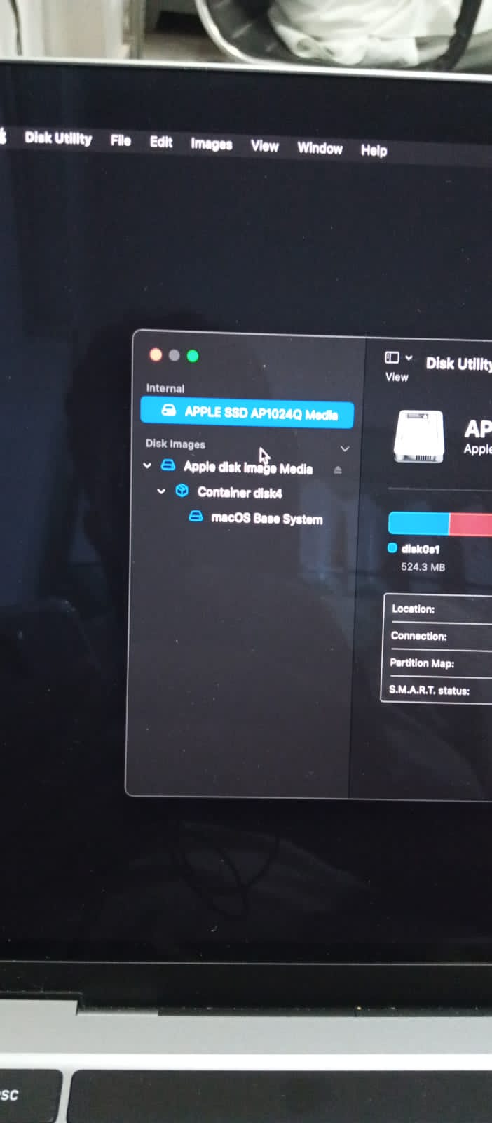

Not messed with this for quite some time, but I’m seeing the 1TB drive with no containers. I was under the assumption you need to create a container first - unless my memory is all levels of wonky.
They're erasing the "whole disk" / top level drive (i.e. "Apple SSD ...") Shouldn't it create a container automatically?
Possibly, but I seem to remember reading of times where users had managed to do something that resulted in the sort of thing happening.
Like I say, it’s been an age since I last ditzed around with this (I got a little to excitable on an old MBP and managed to delete pretty much everything!) and was left pondering for a while how to proceed since I’d never touched APFS before (I came from a Windows background - and before that, Unix).

I’m going to try with Apple Configurator. This issue happens when you use erase device option from iCloud on an M1 Chip!
I’ll try and post the results. But it’s a big mess to work around

On it
I’m not sure if I should go in the revive or restore option. Because recovery system is working fine I think I’m go to restore
Reactions: basher
Revive only restores the firmware - that will not fix the issue. You need to do a restore I think
Got it
I’ve asked a friend to lend me his mac for day let’s see
It took a lot of time due to net issue. But it is working now after restoring with Apple Configurator
