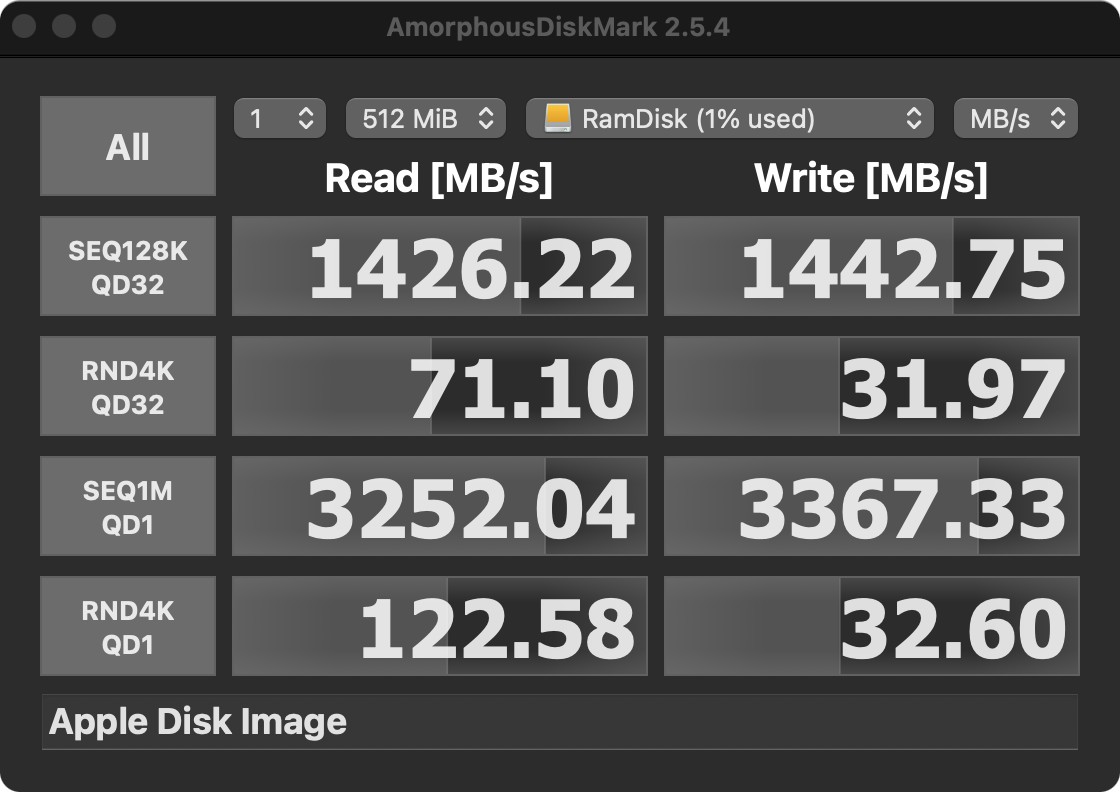

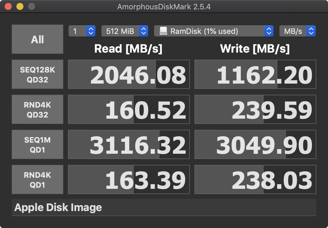

Anyway, a little bit side topic here. I did some tests to see how different file system affect storage performance and here is the result.
APFS
HFS+
ExFAT
