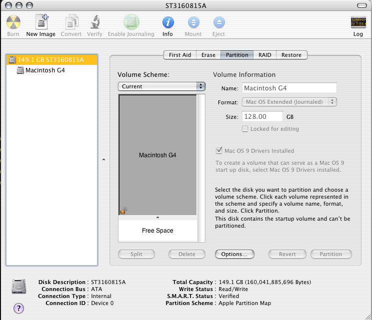

I recently purchased a G4 Mac from Craigslist. I am happy with the machine but there is one thing that bugs me at the moment. Disk Utility shows that I have about 20GB of unpartitioned free space on my computer. I have included a screenshot to this post to indicate what I mean. Is there any way I can use this space as a separate partition? Perhaps maybe as a Classic Partition? I've tried using diskutil under terminal but it does not it only shows me information about the active partition.

do you have access to the folder?
i also noticed that the disk contains the start up and cant be portioned.
you might have to unite the drive, then repartition the drive to your settings.
or try rebooting to that drive.
I would wait for more advice, there are members here who use that osx daily.
but back up that drive (no time machine) because that OSX is hard to find for the G4.
I would also make DVDs of that OSX that are bootable, i had a G4 PowerBook that was useless after the original hd broke and i could not find the dvds that went with the exact PowerBook.
Your Mac has the large drive limit. That means, that natively, you can only format up to 128GB. Fortunately, there is an answer to your question.
The HiCap driver will allow you to format the rest of the drive. Keep in mind, it's always going to be a second partition. There's a way to make the driver format the entire drive as one partition, but it's sort of involved.
Do not store anything you do not wish to lose on the other partition as without the driver installed (on other Macs say) you cannot see the extended partition.

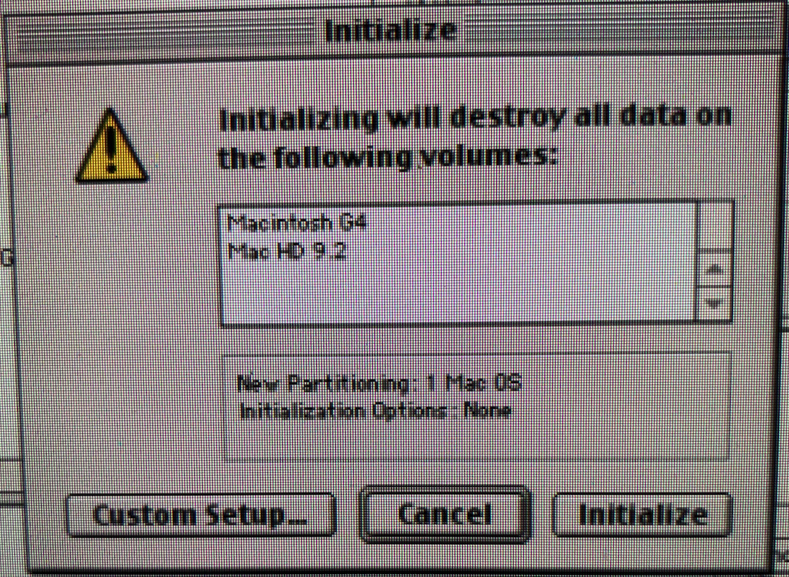

So I was able to create the additional partition on my disk. However, I tried formatting the partition as MacOS Extended and installing OS 9 on the the extra partition. I kept getting an error stating that the disk did not have enough storage even though it was at around 20 GB. Now I can't boot into anything, the system shows a blinking folder folder with the Finder graphic on it.
In the OS 9 install disk, when entering drive setup it shows that disk is not initialized.

Did you follow the instructions from the HiCap Driver concerning OS9?
You need to format from OS9 using HDST (Hard Disk Speed Tools). That's a separate product. Probably have to search macintoshgarden for it.

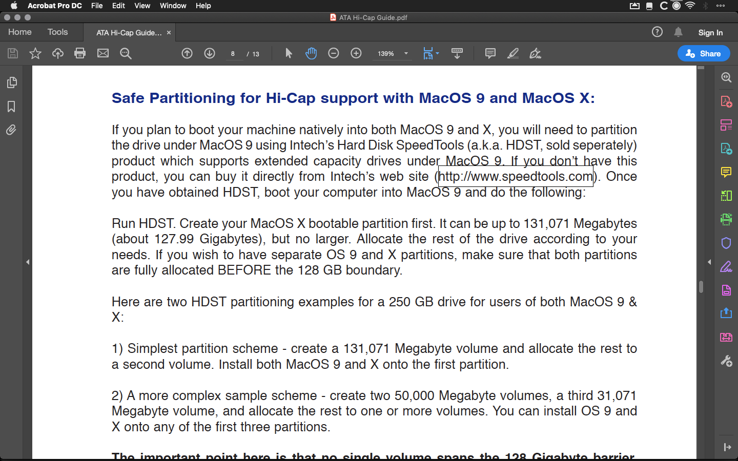

PS. I actually bought this product when it was being sold online, so I have some familiarity with it - just not the OS9 stuff. The PDF manuals they included have been sitting on one hard drive or another of mine over the years.

Here's what I have.
  • Hi-Cap for MacOS X 10.5 Guide.pdf
  • ATA Hi-Cap Guide.pdf
It says on these documents that I can boot from my OSX installation disk. I have the installation disk but it always prompts setup. Is there a way I can boot from there, bypass setup, and run disk utility? My installation disk is 10.1.3.
