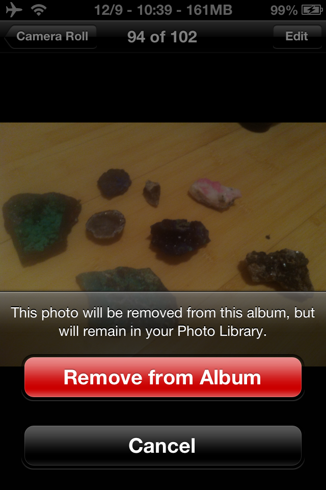

I installed "swapcameraroll" onto my iphone 4, 6.1.2. THAT was a huge mistake. I have no idea if it even worked the way it was supposed to. The app would crash as soon as I would open it. I uninstalled it in cydia, and now, whenever I want to delete a photo in my camera roll, I get a popup on the bottom that states, "This photo will be removed from this album, but will remain in your photo library." and gives me two boxes to click (er, tap, whatever) on, "Remove from album" and "cancel."
I installed it again, opened the app (swapcameraroll) a few times, it crashed right away each time. Uninstalled it again, and photos app is still doing the same thing.
The photo that I want to delete from the camera roll is NOT even in my photo library!! WTH!!! How can I COMPLETELY uninstall that blasted swapcameraroll?? Because obviously it has screwed up my photos app regarding deleting photos. I can delete photos fine, but the photos are not even in my photo library. I've included a picture of what happens when I try to delete a photo in my camera roll.

That message is normal because I'm assuming what the tweak does is actually move/copy photos and not provide a shortcut to the photo
if you're deleting a picture from the camera roll, once you've deleted it. plug it into the computer via usb and check if it's still there. if it's not, then the picture is deleted.
otherwise, it would be warning you that there might be another copy in another album
I looked this up and it seems it's for iOS 4.x. It creates an alternate Camera Roll (not just an album). Think of a cassette tape. There's the A side Camera Roll (your usual) and a B side Camera Roll (the flip side), both of which can contain albums. Depending on which Camera Roll is loaded at a time, a connected PC will only see the currently active Camera Roll. In this way you can "hide" an entire Camera Roll from whomever you don't want seeing it (or knowing it's even there).
My guess is that this photo is somehow stuck in the alternate unavailable Camera Roll and since that Camera Roll can no longer be accessed because the tweak has been deleted, Photo.app crashes when you try to remove it. Swapcameraroll is probably crashing on load because it was intended for the iOS 4 Camera Roll and is being used on iOS 6.x instead. Presumably Apple made changes to the Camera Roll since version 4.x. I would guess then that swapcameraroll has probably corrupted the default Camera Roll.
No idea how to fix this though, I'm just speculating.

The PHOTOS app is perfectly fine, it doesn't crash. When I had SWAPCAMERAROLL, the swapcameraroll app would crash. My photos app is perfectly fine except the popup on the bottom when I try to delete photos from the camera roll.
Shouldn't the NORMAL popup only have a box for "delete" and "cancel" ??

I'm inclined to agree with Erik. Even though the app "looks" fine, that does not mean the file structure was not drastically changed by the tweak. I'd open up I file and do some investigating of the folder structure and compare it to the stock app if you can locate it.

I found the culprit. It was a tweak called reorganize photos or something to that extent. It allows you to put photos into a different folder and also allows you to reorganize the photos in your photos app.
After I uninstalled it, the delete function is acting normal again.
