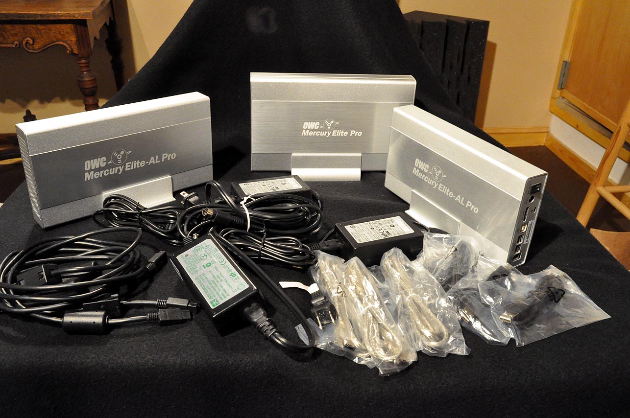

My Equipment: On average each data enclosure's DC output power supply is roughly +5V/3A (or) +12V/3A. Also using #2 Older Apple Display Monitors and an older Mac Pro Desktop. I'm currently looking at possibly #2 Model (SC450RM1U) power supplies, each one provides 280 Watts / 450 VA.

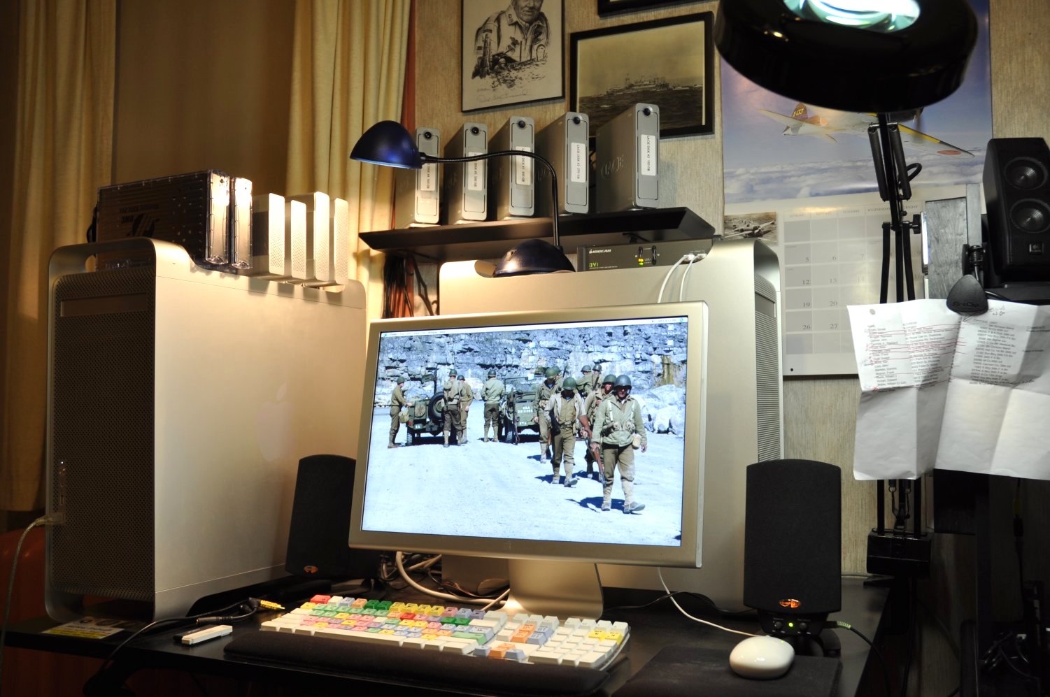

Sample Back Story
Web Page

Looks like a very worthwhile project!
As an aside, the Macs in this photo are both Power Mac G5s and there does not seem to be a Mac Pro (unless it's not in the photo), but this does not impact the discussion. The UPSes should communicate fine via USB even with those old systems running old versions of Mac OS X.
Depending on your workload, a 1500VA UPS might not be adequate for all of that equipment. Power Mac G5s with CPU and graphics board running at high utilization (which I assume they would, when you are editing or exporting hi-def video) can easily consume 400+ watts—and you have two such Macs.
I suggest picking up one UPS and testing it with your setup. The UPS LCD can be set to show the power consumption of all the equipment connected to it, so you can connect a portion of your equipment, do some test editing/exporting runs to rev up power consumption, and keep an eye on the LCD to see what kind of power you're drawing. If you have enough headroom, connect the rest of your equipment and re-test, or if not, consider adding a second UPS. Overloading the UPS can cause the UPS to cut power to every connected device without warning.
