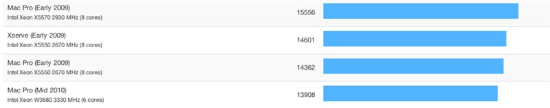

980x is reality work!!!! Please see screenshot! Ram is exchange to the non ecc 16gb, because not work on the 980x!!!!!! Geekbench result is very good!!!!
980x faster vs 8-core xeon 2,93!!!!!
980x cinebench faster about 2x rated of xeon w3520!!!!, BUT SLOWER 8CORE 2,93(((
The tests geekbench on the Internet, my upgraded mac pro of faster on 1260 points, the maximum of mc561 2400 MHz (8 cores) and closer to the Mac Pro 2660 MHz (8 cores), losing his 460 points, which is understandable, for the simple arithmetic, 3333 * 6 / 8 = 2500 + ~ 100 MHz due to the fact that all nuclei in the 6-core processor on a single processor, rather than two as in the 8 core, so the communication between cores faster. That is 6 cores of 3.33 8 cores are similar to 2600, which explains the slight lag of 8 core 2660 and a significant advance 8 core 2400.
