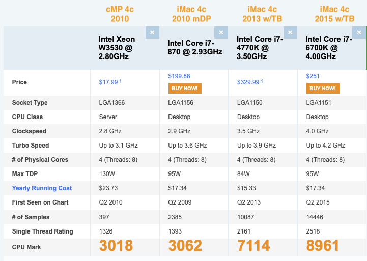

While an iMac 2010 i7 is almost a perfect match to your Mac Pro performance wise, you can't have any usable OSX with it after High Sierra. It's good for running older stuff or as an external target mode display, but not for anything more anymore. I've got a few of those as leftovers, and use as a monitor at times, or when in need to dig some old stuff.
There's no thunderbolt either, so you would need to find cinema displays for that, you can't use tb-display with it.
I'd suggests you go for a few years newer if you want a cheap intel iMac. You'll get a lot more performance out of your iMac with newer i7s (see list). Both single core and multicore fare way better than a 2010 iMac. You'll get the thunderbolt too (different versions of it, but they will work with TB display). Of course newer ones cost more too, but I wouldn't buy a 2010 iMac for anything of daily use aymore, because of High Sierra cap. No patch or open core will help with it, the GPU is not capable enough, and changing the GPU is more for tinkerers than for daily users in my opinion.
Please see attached CPUbenchmark.net comparison. I marked the Pro €core and the i7 iMacs for you at the topmost row. The i5s are good too, (not in the list) performance of i5s is not that far away from i7 models from that same time period.
With 2015 you get a Retina display too, don't know if that's a desirable or not feature for you and your work.

And yes - sorry was a bit confusing with the terminology I used. I just meant - an iMac from 2010 - 2020; but given pricing, probably a lot closer to 2010 than 2020...
Looking at the above chart that you've kindly provided, I'd say the 2013 iMac may be a good choice. They sell for around $500 - $800 AUD on eBay. Will need to look closer at the specs, but it's in the ball-park.
