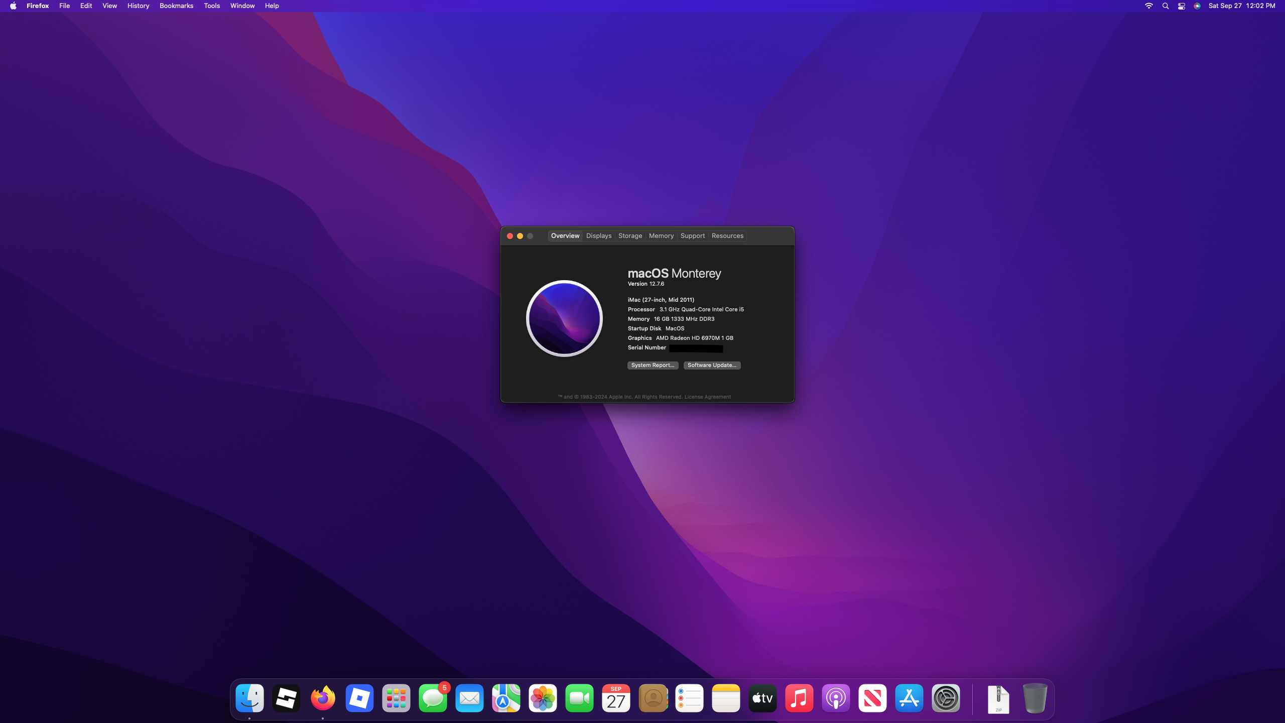

I was able to boot into it, install the system, and patch it using the OCLP Patcher. It worked but had some graphical issues with menus flashing. I thought meh, I can live with it. While testing it (booting off the SSD through USB), it was still randomly turning off. This led me to believe I was wrong about my HDD failure being the culprit and I researched some more. I found that this could be a sign of the GPU failing so, while I was in there to swap the drive, I pulled the stock graphics card (the 6970m) out, tore it apart, and threw it in my oven for 9 minutes at 200 degrees (400 farenheit). I then redid the thermal paste and tossed it back into the system with the new drive.
I reassembled everything and booted. Oh boy does she fly. It booted in 14 seconds (including log in and desktop loading) where my previous HDD was around 4 minutes. I did not have the glitches on the menus anymore and everything is stable. I can run Roblox Studio which my kid is so happy for. It's like a new machine! Still can't run my Word, Excel, etc on this version, but whatever, I can boot into my windows and do that.

I have upgraded the CPU to an i7-2600 with 3.4 GHz. We will see how this baby compares to the i5 i had installed previously :)
New WiFI / Bluetooth card and GFX card will be here shortly. I fear I have damaged the board when removing the monitor - it's working fine but the tiny connector in the top left is broken slightly. Will keep an eye out for that!
Processor Name: Quad-Core Intel Core i7
Processor Speed: 3.4 GHz
Number of Processors: 1
Total Number of Cores: 4
L2 Cache (per Core): 256 KB
L3 Cache: 8 MB
Hyper-Threading Technology: Enabled
Memory: 32 GB
System Firmware Version: 87.0.0.0.0
