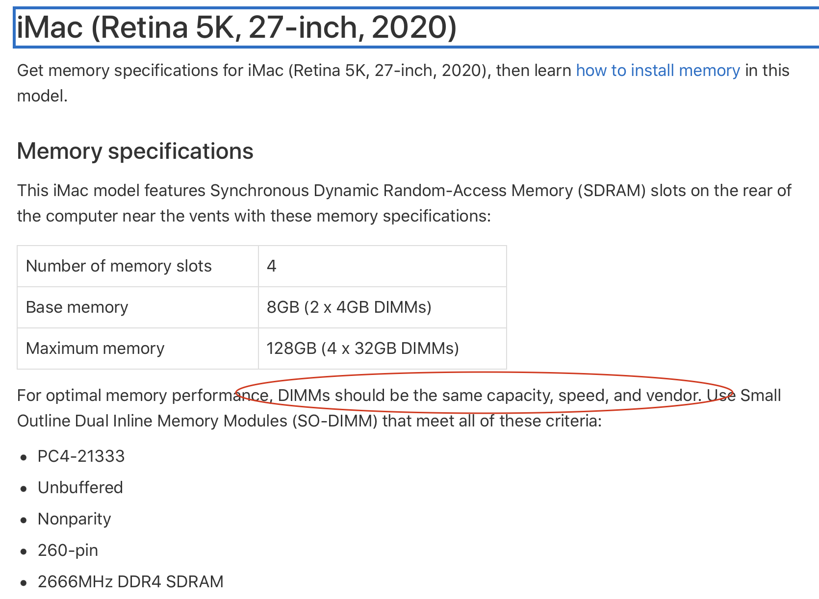

If it is a 2020 27" iMac it has some quirks about RAM: all sticks must be the same size and identical (with some exceptions) else RAM performance drops. Still works, but at a slower speed. Best not to mix.

There are some long threads on upgrading RAM in the 2020 iMac, but this is what Apple says - note the red circled words appear only for the 2020 iMac, and not for any other models. Why, who knows. It may just be a firmware bug. Regardless, if you mix DIMM sizes across 4 slots in the 2020 iMac, either the speed drops from 2666 to 2133 MHz, or you lose full dual channel (depending on how you mix them), and the result is that the tested RAM transfer speed drops, for example as tested using NovaBench.
