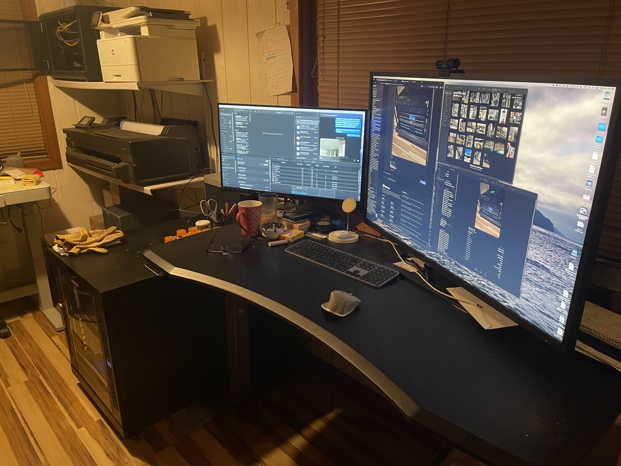

Mines a server mount: Sonnet xMac server with a 2018 Mac Mini, 4Bay OWC Flex 1U4 Thunderbolt enclosure with four 16TB drives inside + New M2 Mac Mini Pro on top. Two 4K monitors, HP Plotter, HP Laser Printer, + my home office wired network. As you can see its only drawing 23%. I've had it for a year. Commercial grade. Say away from consumer types. No complaints. Does the job. Money well spent!
