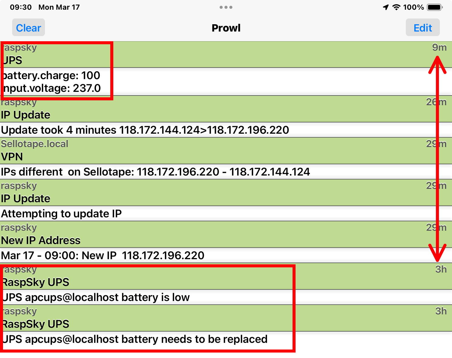

I check and log the battery state and input voltage daily. Here's recent log entries:
Code:
Mon Mar 10 09:20:09 +07 2025 UPS Check battery.charge: 100 input.voltage: 237.0
Tue Mar 11 09:20:07 +07 2025 UPS Check battery.charge: 100 input.voltage: 232.0
Wed Mar 12 09:20:07 +07 2025 UPS Check battery.charge: 100 input.voltage: 237.0
Fri Mar 14 09:20:25 +07 2025 UPS Check battery.charge: 100 input.voltage: 232.0
Sat Mar 15 09:20:15 +07 2025 UPS Check battery.charge: 100 input.voltage: 234.0
Sun Mar 16 09:20:14 +07 2025 UPS Check battery.charge: 100 input.voltage: 232.0
Mon Mar 17 09:20:15 +07 2025 UPS Check battery.charge: 100 input.voltage: 237.0
Tue Mar 18 09:20:15 +07 2025 UPS Check battery.charge: 100 input.voltage: 234.0
Wed Mar 19 09:20:14 +07 2025 UPS Check battery.charge: 100 input.voltage: 234.0
No entry for March 13th as that was the day of the long power outage.
