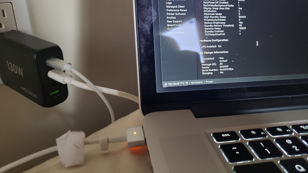

Most of the USB C to MagSafe adapters I've tested only support 60W, even if they claim higher. I can't find it on Amazon anymore, but one which did NOT advertise 85W actually supports 85W.
It differs from most of them by having metal casing on both usb c and MagSafe ends, where most of the others have plastic (or rubber?) on at least the usb c end.
