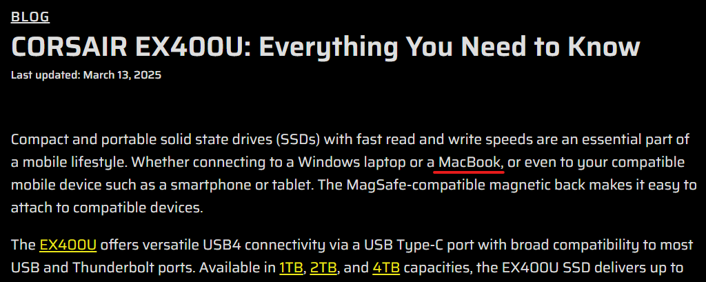

The enclosure Phison chipset isn't compatible with the M4 Macs in USB4 40Gbps mode. It works through hubs because as someone already stated this switches it to a different downgraded slower USB mode. If you don't need the full 40Gbps mode you can get a different USB cable that simply doesn't support 40Gbps and it will force a downgraded connection without needing a hub in between.
The alternative is to return this expensive garbage to Corsair and let them know they should put a disclaimer on their website and test their products with the devices they're supposedly compatible with. As far as I can see they don't offer a guarantee that it works with M4 Macs specifically instead merely claiming that it works on all Macs.
It's the typical thing to state when they haven't tested with any particular machine. M4 Macs and this enclosure were released at roughly the same time so perhaps Corsair didn't even have a M4 Mac available at the time of testing and merely assumed compatibility.
Compatible with any Mac is a wild statement since Corsair has absolutely no way to ensure their product will work with future Macs that don't exist yet. How could Corsair possibly guarantee that it works with hardware that doesn't yet exist on the market? And what would they do if years down the road one of their products ended up becoming incompatible, would they refund the customer? I highly doubt it.
Now you could assign part of the blame to Apple because we know Apple's USB-C ports are picky what devices and chipsets they accept. But ultimately it's Corsair that incorrectly claim Mac compatibility.
There are other 40Gbps NVMe enclosures available that actually work and 40Gbps external SSDs are sold by Samsung and others and these work as well. So clearly the Macbooks do support 40Gbps. The catch is that these working devices have an Intel chipset instead of the incompatible Phison. I think there is a compatible Asmedia chipset as well.
By the way I am a fan of Corsair hardware and have a lot of it and Corsair makes quality products. My complaint is merely towards their marketing that makes impossible universal compatibility claims. Or it's simply an error on their website. But the end result is the same that the enclosure doesn't do what it promises and the customer ends up with a headache.
I know Corsair is participating in this forum in some capacity so perhaps they end up seeing this and can find an employee with a 14"" M4 MBP (not M4 Pro/Max!) and verify that their enclosure indeed won't work with the included 40Gbps cable.
