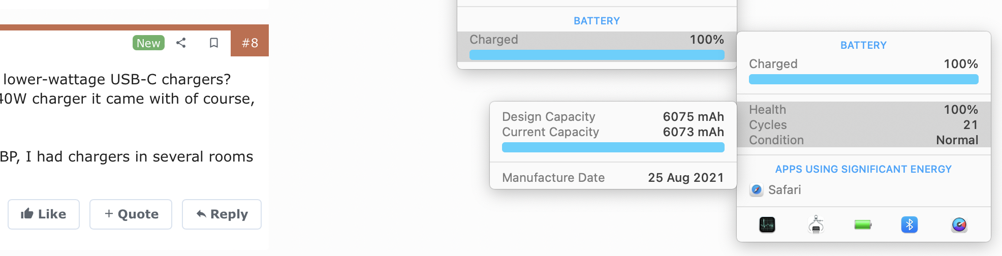

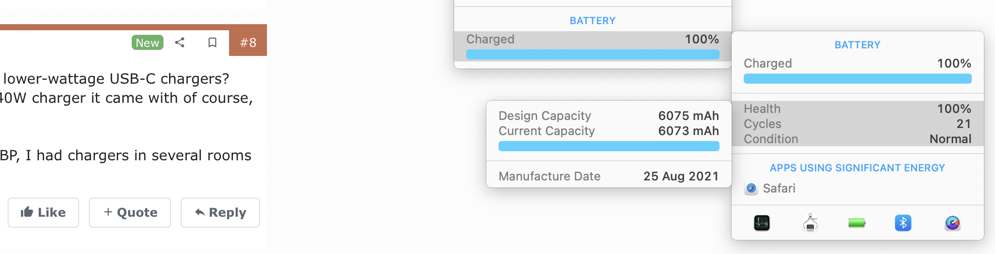

There is no risk in my experience - I use a 30W MacBook Air charger for my 14" M1 Max, most of the time running the Mac while charging. Even while under considerable CPU load, max memory usage (64GB) and driving an external monitor the Mac still charges slowly. The battery health is still excellent after 21 cycles and 3 months of use - hard to put complete cycles with this sort of battery life.
