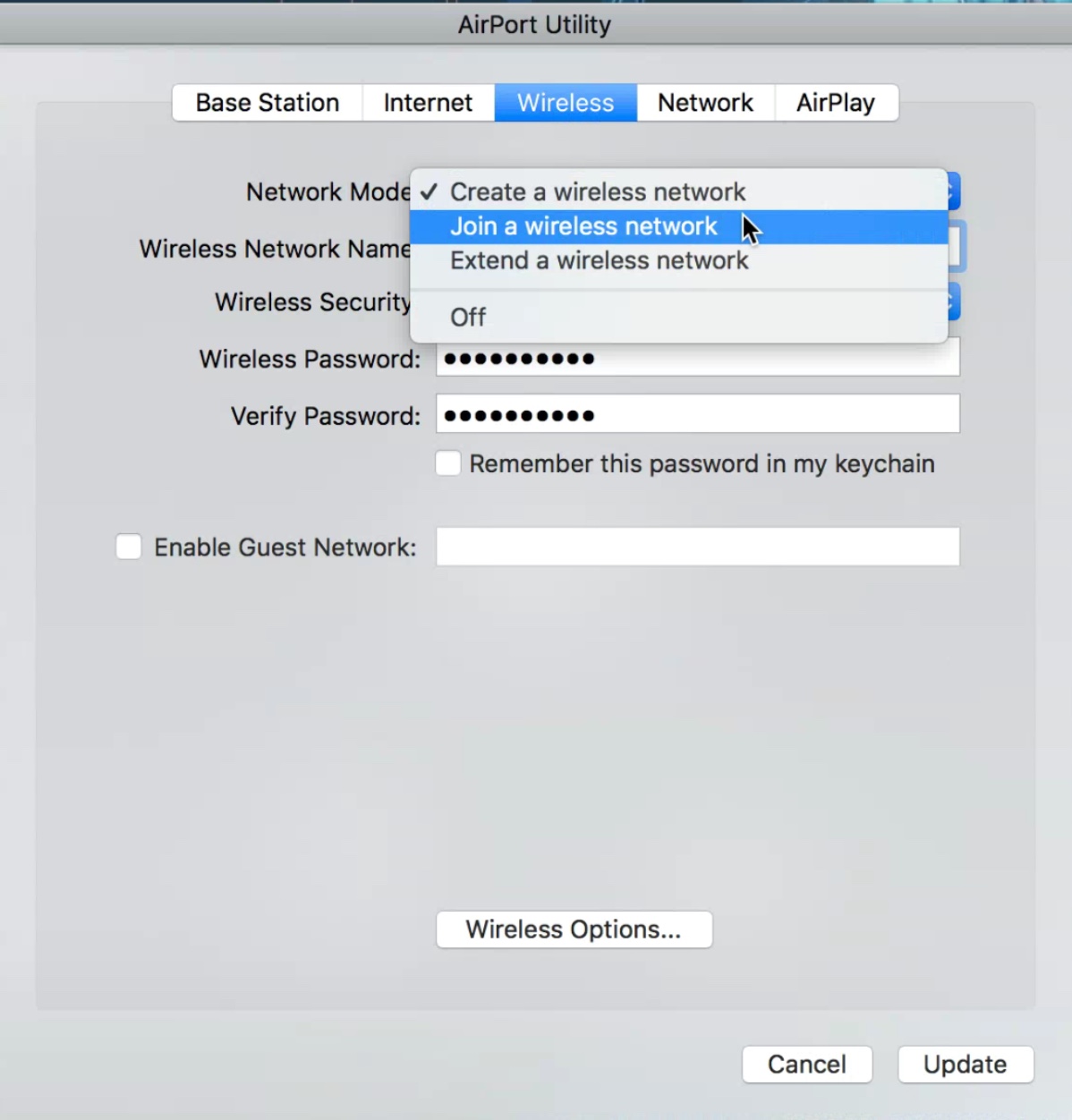

Hello,
My mac pro doesn't have wifi card, so i've bought a Airport Extreme as wifi adapter
I would like to set up like this:
Mac pro ----- ethernet -----> Airport Extreme ------ wifi ------> internet router
I'm trying to set up but i cannot, can someone give me some tutorials plz
thank you

No, it won’t work, only Airport Express can work advance a Wifi adaptor, AirPort Extreme cannot.
However, Airport Express only has 100Mbps LAN port, therefore, everything will be limited to 100Mbps (about 10MB/s). That may be OK for internet, but considered super slow for intranet.

This can only extend the WiFi network, but won’t capture the WiFi network and covert it to the cable network. I tried. The option OP need is the “Join a wireless network”, not the “Extend a wireless network”. This option only exist in the Airport Express.

I just checked my setup and confirmed my prior post. It is set to "Extend Wirelesss Network" to connect to my main SSID. The ethernet ports are live and carry my network. My BluRay hooked to it configured via DHCP from my router and worked. This means that it also rebroadcasts the WiFi.
I looked and it lacks the option to "Join a wireless Network," which would just bridge the WiFi to the local ethernet and not rebroadcast the network.

For me it works this way. I have one AP Extreme (802.11ac / 7.7.9) providing WiFi in my living room. It gets its internet connection from a pfSense router. On the other side of the room I have another AP Extreme (4th generation / 7.6.9) set to extend the wireless network. An ethernet cable goes from there to the Sky TV box. No problem.

I use a spare Airport Extreme as wifi adapter on my workbench to check / repair mac boxes without wifi - and to check the Ethernet Ports. Join a wifi network is the way to go.
Old Airport Extremes can go for low $ so its not too bad to use some - and you dont need to fiddle with drivers.

May I know if you are also “extending” another Airport’s Wifi network?
If yes, that may be the reason why both OP and me can’t make it work. e.g. this extend function can only serve as Wifi adaptor if the other end is also an Apple transmitter. And this also explain why there is a “join the network” on the Airport Express. Which supposed to be used outside our own place (e.g. in a Hotel), which the network is not created from an Apple Airport. Therefore, cannot be “extended”, but only “joined”.
I do extend a wifi network what comes from a time capsule. But using the Apple Airport Express as wifi - ethernet bridges works from the A1264 on, even when just joining. I used them a lot for this on a non Apple router, too.

Airport Express definitely can join any network and use as a Wifi - cable bridge.
But I wonder if AirPort Extreme can only work as a bridge on an Apple network.
I always thought that Apple made a mistake not allowing their only AC wifi router to be be put in bride mode (join a network only) vs extending the wifi network (cutting the wifi speed in half when when a device connects to the "remote" router/bridge.

That is my understanding of the matter. Extending a wireless network seems always vendor specific. I never achieved extended Wifi between different vendors. And joining a network doesn't exist on AP Extremes.
