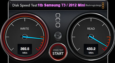

I booted my 2012 Mini from a 1TB USB 3 Samsung T3 for several years and it worked great (the T5 is the updated version of the T3). It is dead simple.... format the SSD for MacOS, use Carbon Copy to clone the internal disk to the SSD, select the SSD in the startup control panel.... and be happy! :)

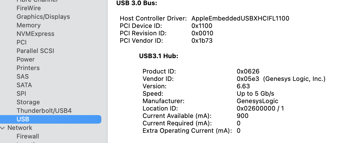

Make sure the drive interface AND cable are USB 3. Check System Reports and ensure you see "Up to 5 Gb/s"
Otherwise, it's just a fast USB2 drive (slow)
