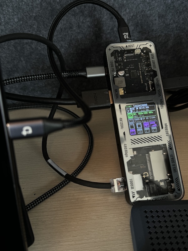

i use this hub with the m4 pad 13 2tb -
these tb4 cables as well -- https://www.amazon.com/gp/product/B09ZPF15B3/ref=ox_sc_saved_title_1?smid=A234BDUVIWM321&psc=1
Reactions: lsquare
