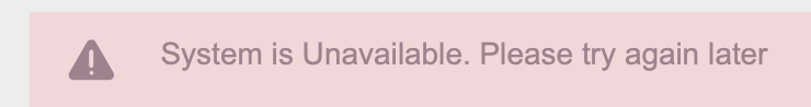

Later on, I try to update the E911 address and : it will not take my home address on the Verizon Wireless website

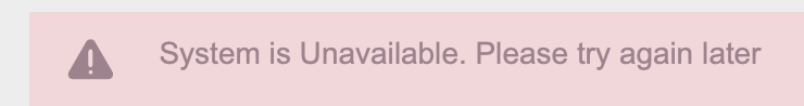

Later on, I try to update the E911 address and : it will not take my home address on the Verizon Wireless website View attachment 1900005
