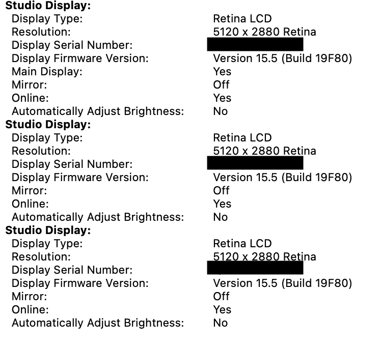

I'm 100% sure that this cable works!
I have three ASD connected to my Studio. Two use that cable and the middle one (close to the Studio) uses the short TB3 cable that comes with the ASD. See attached screen shot showing all three displays getting 5K resolution.
