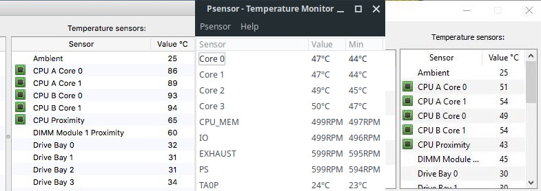

The problem is that under El Capitan the CPUs are always too hot. Macs Fan Control says about
85ºC (185ºF) CPU A Core 0
88ºC (190ºF) CPU A Core 1
91ºC (195ºF) CPU B Core 0
93ºC (199ºF) CPU A Core 1
This is using the Mac Pro not intensively. Mac Pro rear is really hot as is the air coming from the fans. CPU_MEM fans quick-in at a low 635rpm when a CPU core reach 96ºC (204ºF) and then they don’t blast much more. To cool the CPUs I need to full blast the fans using Macs Fan Control. It seems Mac OS X is fine letting run the CPUs so hot!?
Under Solus linux (getsol.us) the temperatures are almost half the temps seen under El Capitan and the fans remain silent. The rear is not hot and the air is just mild warm. Same lack of hot temperatures happens under Windows10. Both Solus and Windows10 running natively.
This high temperatures on El Capitan are a really nuisance. Under Snow Leopard (10.6.8) the Mac Pro is cold. Why is the Mac Pro CPUs running so hot under El Capitan? How can I fix this?
My DC G5 2.3GHz is way cooler, the air from the fans is cold even when the fans rev up!
Left to Right. El Capitan, Solus and Windows10 temperatures.
Thanks!!

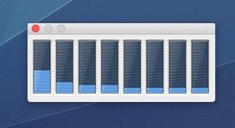

Nothing at all. Activity Monitor the hightest, under 10%. There is no stress on the computer but the temps are high.
You seem to still have only four cores, should have 8. Is there 4 or 8 cores in activity monitor?

These are the temps just after booting, CPUs hot, DIMMs OK?

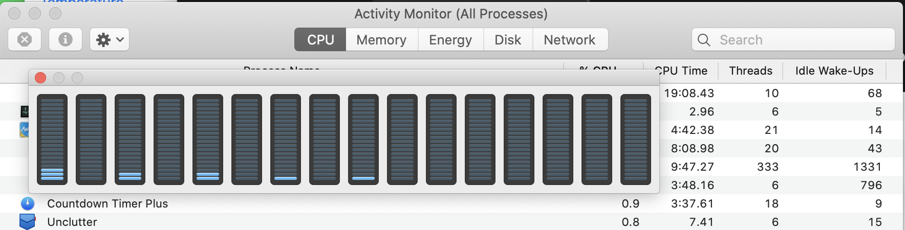

That's probably just due to hyperthreading. Here's my 8 core iMac Pro for example, showing 16 cores.
Oh, do you mean I may be missing one CPU or four cores? I think this CPU does not do hyperthreading?
No hyper threading, you are correct, these 5355s don't have HT.
