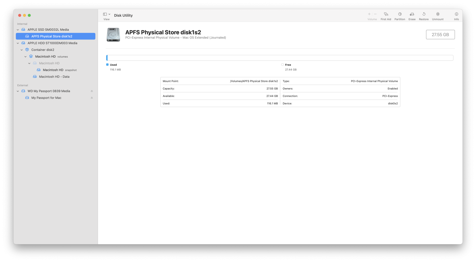

Hi,
Background:
Our 2017 iMac was having a small issue with the Music App controls. After contacting Apple support and following all their recommendations we no longer had an OS and the HD couldn't be found for reinstall. While waiting for Apple call-back I tried recovery mode again but held command & r keys longer then usual and it opened a newer looking version of recovery, which allowed me to install a different version (I forget which). Apple called just as it was completing and they stayed on while I updated to Ventura and all seemed fine.
Issues:
1. However, now the iMac is super slow. It's constantly "thinking", sometimes beach balls but usually just very long delays with internal rumbling while trying to do anything really. Lots of other problems I've been fixing as I go. For instance, our photos were gone, so when prompted, I updated from the suggested location but then it wouldn't share folders because it wasn't a system photo library. Any way things just not behaving as normal.
2. Also, at some point I noticed what seems to be an extra disk in disk utility. Not the extra one from Catalina (Macintosh HD/ Macintosh HD-Data) but under a separate tree, now there are two separate trees and three volumes. It's named APFS Physical Store disk1s2 but is formatted as Mac OS Extended (Journaled). It also keeps showing up on the desktop which never happened before. I've tried un-mounting it from disk utility as well as ejecting it from the desktop but it keeps coming back. I'm wondering if this has something to do with the iMac's performance.
Next, depending on what I hear here, I will try erasing everything resetting back to original condition. Then update to Ventura and install back-up from external drive using migration assistant.
(Oh, and after all this, the music app controls glitch still remains😤)
I've attached a screen shot of disk utility.and
Thanks in advance,
Niwashikun
This looks like one of the models with the 2-part "fusion drive" which had a small PCI-E hard drive that was bound with the primary boot volume as the cache.

It looks like it is a 1 TB fusion drive. The 1TB Fusion Drives in the 2017 iMacs had a tiny 32GB SSD (some earlier 1TB Fusion Drives had a much larger 128GB SSD). So, defusing the drive and running off the SSD is probably not realistic.
You could do that for troubleshooting purposes, if you just do a fresh install to the SSD, you can test to see how it runs. I think 32 GB would be enough for a fresh install.
If you have an external drive to use, preferably a SSD, you can use that for troubleshooting as well.

It looks like you splt the fusion drive when you installed the OS. See https://support.apple.com/en-gb/HT207584 for how to fix the split fusion drive. You will have to reinstall the OS though as fixing the split will erase the data.
Thanks for the reply.
Yes, using that link, I confirmed I have a split fusion drive.

The internal drive is making your whole machine run slow because it is slow. You’re prob reading and writing at 100mb/s. I don’t mean install from an external drive. I mean Run your whole machine off the external, as the SSD I recommended running over thunderbolt would give you a system that reads and writes at night 3000mb/s, dramatically improving your whole systems performance. Then forget the internal drive even exists. Use your passport to back the SSD up.
Reactions: KaliYoni
What YEAR was the iMac you have made?
It looks like it has a "fusion drive" (small SSD and larger HDD "fused together" through software), but the "fusion" has been broken.
When you re-installed the OS, you installed it onto the SLOW platter-based hard drive.
I'm going to GUESS that the SSD portion in this one is too small to use as a "standalone SSD" -- looks to be only 32gb.
As mentioned above, I believe the best solution would be to buy a USB3.1 gen2 external SSD, and configure that to be the new [external] boot drive.
