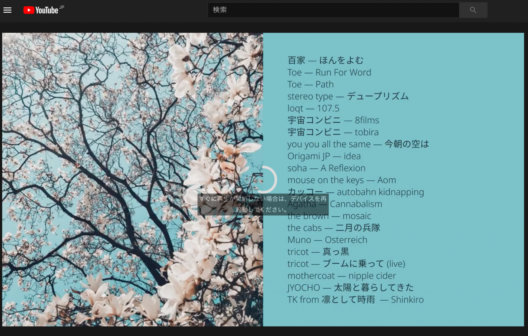

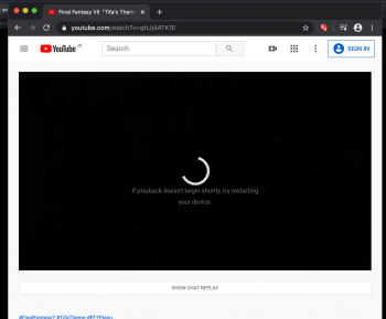

I'm having a strange issue with video streaming, which suddenly stops working (as if it was not able to buffer anymore). It happens on different websites (I tried Youtube, Netflix, Vimeo) and browsers (I tried Safari and Chrome), so it has to be a system issue. restarting wifi or browser doesn't help, I need to restart whole macOS so it can work again. It's not a problem with network because i keeps working perfectly fine on my phone or PS4. It doesn't happen constantly, once in a couple of days. Has anyone else experienced a similar issue? I'm running latest macOS 10.15.4.

When you get the buffering problem what are the results of a network speed test?
I haven't tried that, but everything else seems to be working fine, websites load as before. Just the streaming is an issue. I also noticed that streaming internet radio on a certain website also stopped working until I restarted the computer.
I got that issue again, it seems to happen after waking the laptop up. However, I also noticed that audio and video files weren't playing, so it wasn't related to streaming itself.
Turns out changing audio output to built-in speakers fixes the issue. I have the laptop connected over USB-C to and LG monitor, which has speakers plugged in. The issue must be with USB-C (either on laptop or monitor side) not waking correctly after the wake up. Of course, the monitor itself still works fine. Eh, USB-C is great but it has so many rough edges.
Re-plugging the USB-C cable fixes the issue.
