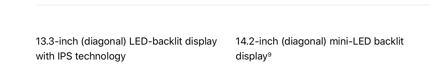

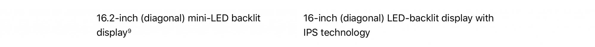

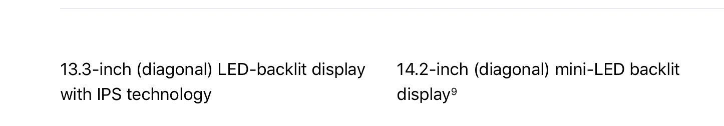

MiniLED is just what’s lighting up a panel, The panel type is what matters. For example You could have a mini-LED lighting an IPS panel that has poorer contrast but better viewing angles or a Mini-led VA panel that has better blacks but poorer viewing angles. It looks like Apple went for better blacks.

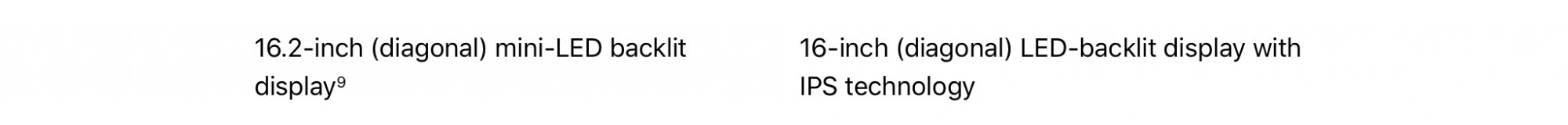

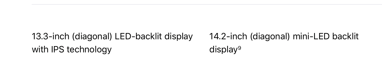

Apple used to advertise the MacBook Pro as IPS displays, they no longer do that on the MBP 14,16 meaning they've moved to a different panel type. Expect the newer models to feature VA panel characteristics
instead of IPS. From the comparison page on Apple's site between 13.3 and 14.2, as well as 16 and 16.2 MBP:

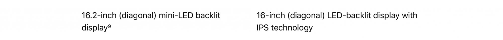

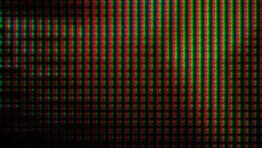

The pixel arrays on the new screens look like IPS to me. NotebookCheck magnifies them in their review.

It could be ADS which is similar but has worse viewing angles. Wording is extremely important, Apple didn’t drop that for no reason, it’s not an IPS panel.
I believe ADS is considered an improvement, including in viewing angles, but its pixel arrays seem to look different. Anyway, doesn't seem any different than before to me in viewing from an angle.

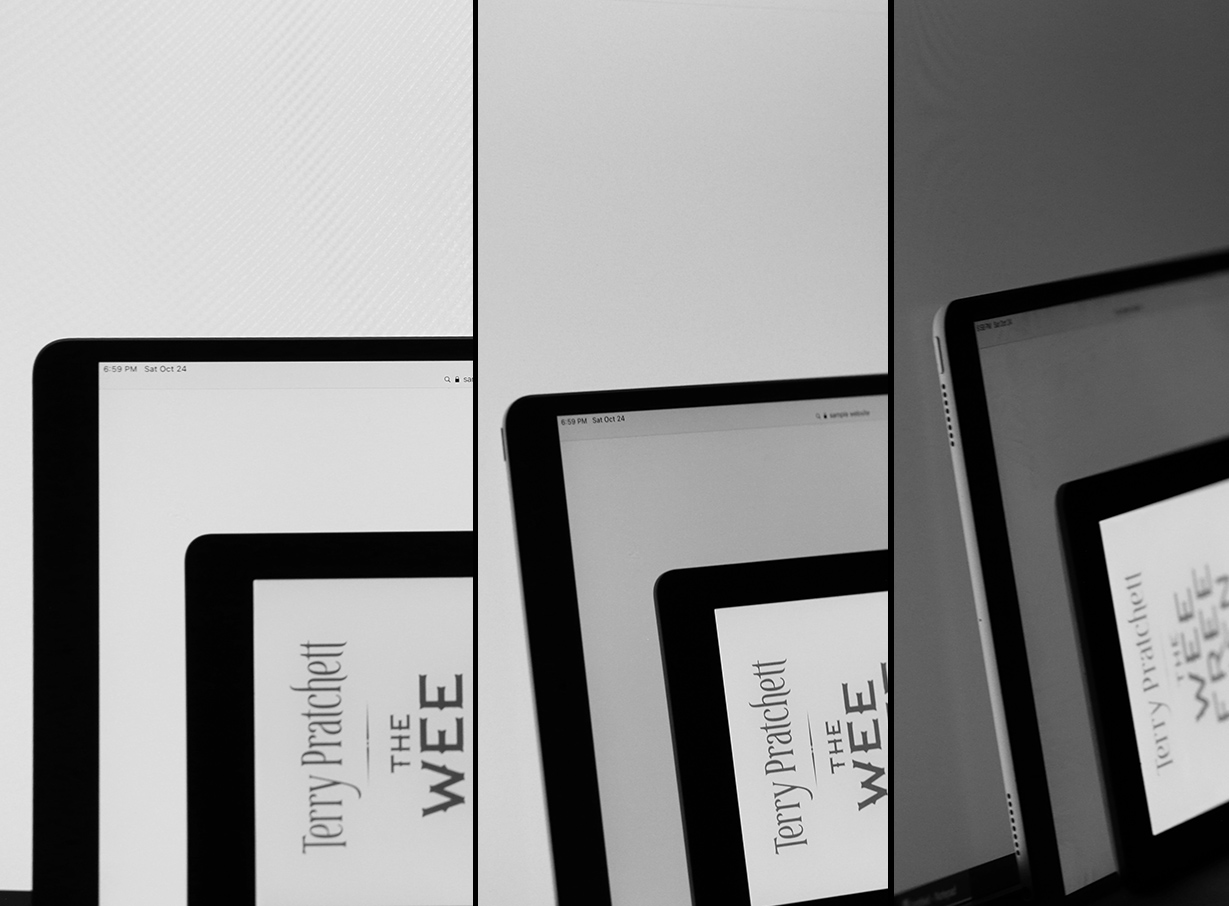

In my experience, portable LCD displays tend to have worse viewing angles than desktop displays.
Here's an example of with a 24" desktop monitor, my iPad Pro 10.5", and a Kindle Paperwhite.
From straight on, a slight angle, and a more oblique angle. I desaturated the pictures to make color temperature differences in the displays less noticeable. Exposure setting is the same on each of the three pictures.
I would guess that the worse viewing angles on portable displays is at least partly due to power efficiency. Any light that isn't reaching your eyes is basically wasted power.
I suspect one of the reasons many people find e-ink displays more pleasant to read is that the brightness stays almost perfectly consistent at any angle. Here you can see how much the iPad changes brightness with even small viewing angle changes. Compare the brightness of the left bezel with the display as the viewing angle changes.

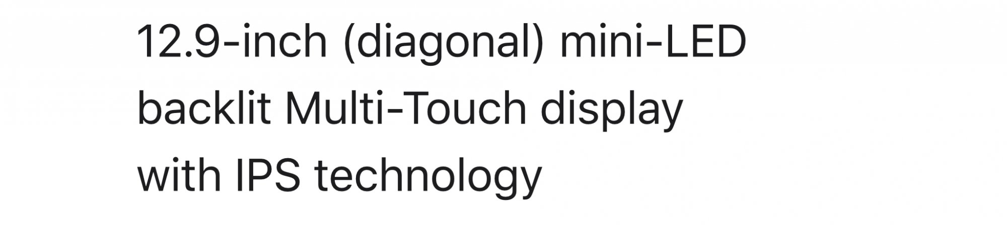

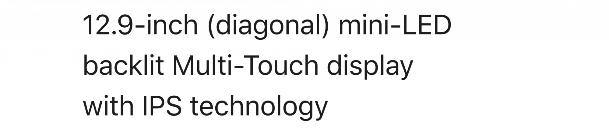

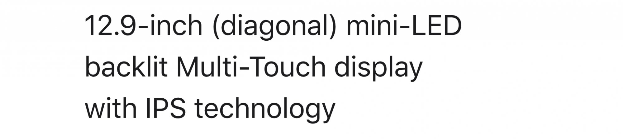

I’ve seen mixed reviews of it. Take the Apple (tech spec) pages wording as exact, technical and chosen for a purpose. Apple has claimed a lot about the displays but has been hush about viewing angles.I don’t believe the new MacBooks have any wide viewing technology (not ADS,IPS, or even VA with a angle filter), I think Apple went with a traditional VA panel to fully show the miniLED advantage. Im even more sure of this because with the miniLED iPad they do still advertise wide viewing.As others have mentioned it really doesn’t matter for screens this small, but I wont be surprised if more people like OP notice in passing. I also wouldn’t be surprised if the iPads drop the IPS in the future, TV’s using IPS and miniLED often show worse blooming, which might be why it’s so noticeable on the iPad. Hell it might’ve been the backlash to the 12.9 that caused Apple to adopt a different panel. Apples been advertising IPS on tech specs since the first retina MBP and the first iPad. The omission on the new MBP models is not a error.
