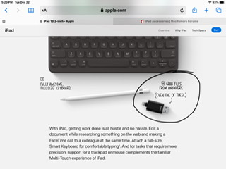

What is this (circled) usb adaptor and where can I purchase that?
