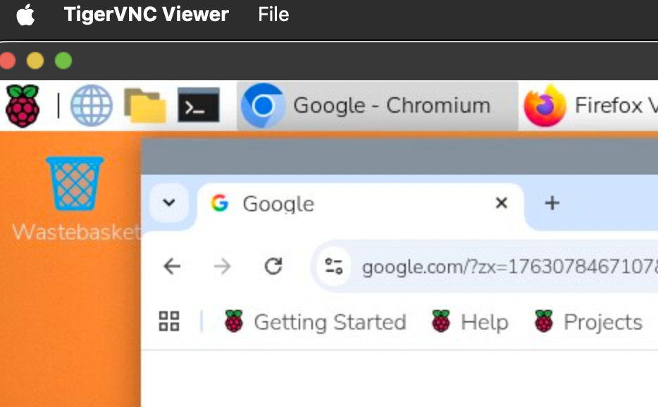

I recently set up a new Raspberry Pi as a print server. I'd like to be able to connect to it remotely. Most things work, but VNC fails.
What am I doing wrong?
This works:
smb://piprint.local
This works:
http://piprint.local:631
This works:
ssh pi@piprint.local
This works:
Code:
Fifteen:~ mnewman$ ping -c 3 piprint
PING piprint (192.168.0.55): 56 data bytes
64 bytes from 192.168.0.55: icmp_seq=0 ttl=64 time=57.052 ms
64 bytes from 192.168.0.55: icmp_seq=1 ttl=64 time=6.883 ms
64 bytes from 192.168.0.55: icmp_seq=2 ttl=64 time=8.809 ms
This fails:
vnc://piprint.local
Code:
Connection failed to “piprint.local”.
Unable to communicate with “piprint.local”.
Make sure the remote computer is
available and the firewall is not
blocking screen sharing.
But it works with the same address with the TigerVNCViewr
And it works with a different Pi:
vnc://raspsky.local
So, what am I doing wrong?
I believe the built-in VNC on macOS doesn't support modern VNC security protocols, and the newer Pi OS versions don't support the classic VNC authentication that macOS built-in VNC supports. That would be why it works with TigerVNC since it supports the modern protocols.
